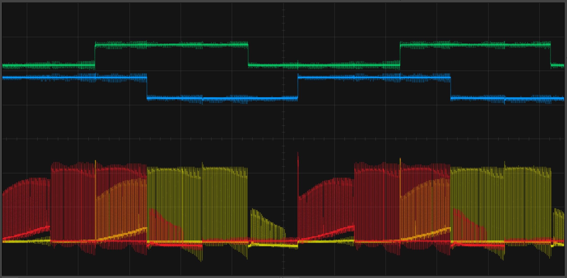

    This is the motor running. The green and blue are the hall signals. Go figure the hall signals are not aligned with where the motor needs to commutate, guess that explains why it won't run in sensored mode. Guess that's a cheap motor for ya. But every motor should run sensorless :( I would appreciate any hints about how to predict the correct commutation time.
    I think you should capture this image when motor is coasting to find the hall sensor errors or you can capture by sniping motor freely with hand (without commutation).
    To find the commutation point, in zero crossing event, start a timer with period value equals to half the time between two zero crossing (half the time between previous and current zero crossing event). In timer period match ISR do the commutation. Adjust offset if any due to software latency etc.
    At higher speed make sure zero crossing detection is proper to avoid the speed oscillation. Because at higher speed number of PWM in one commutation will be less and during PWM off time you will not get zero crossing, it will lead to position (commutation) error. If number of PWM cycles is very few (< 2 or 3) in one commutation, increase the PWM switching frequency.

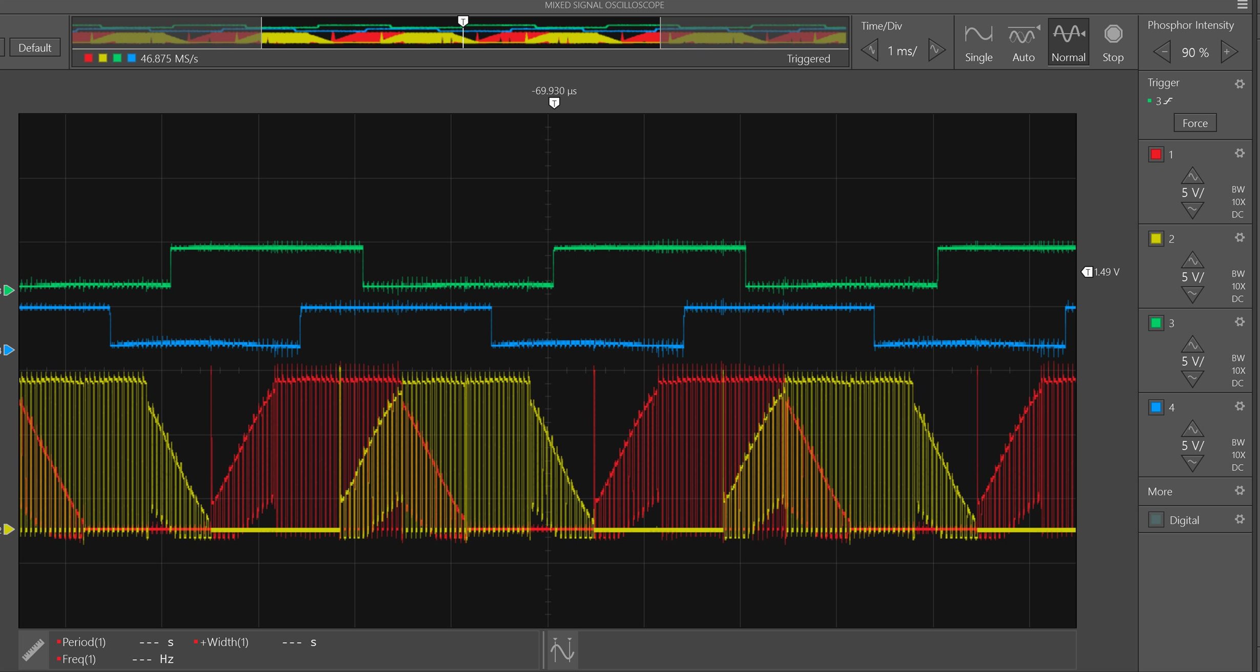

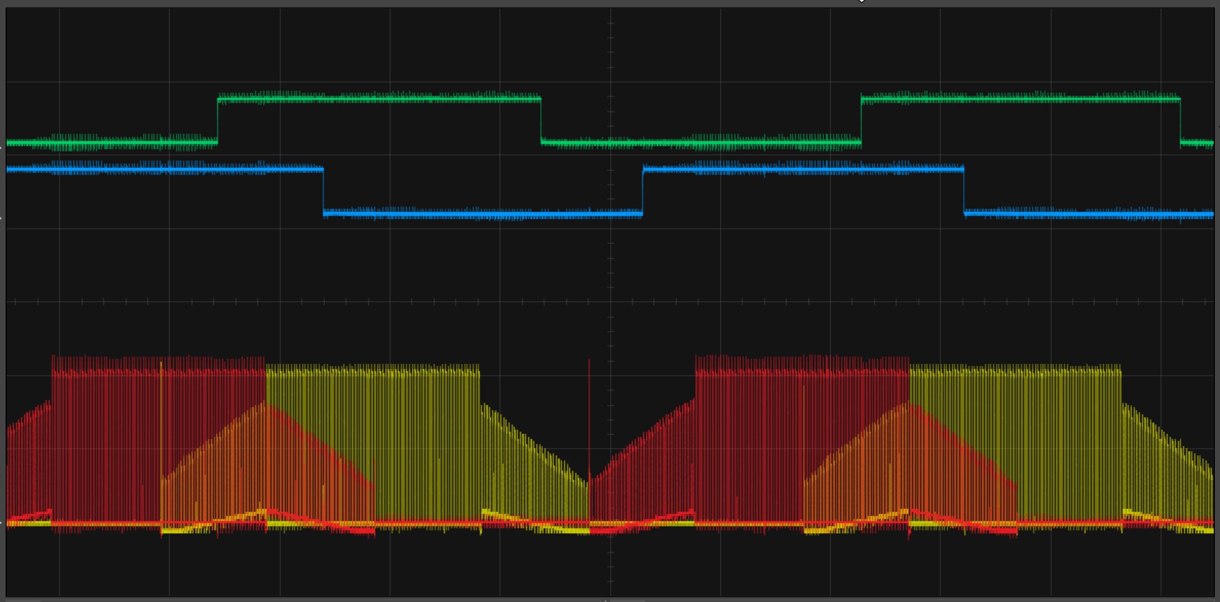

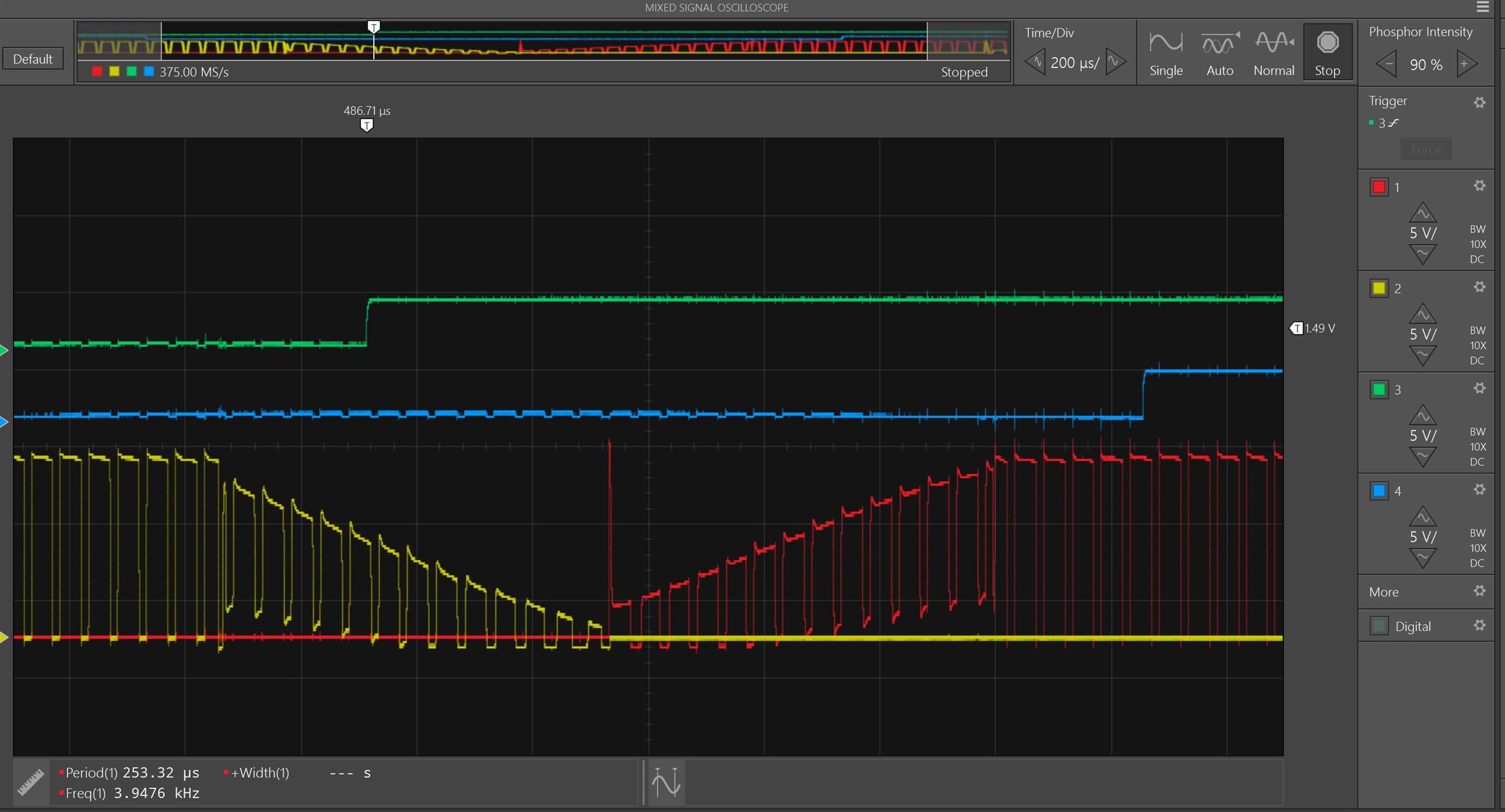

    Let me clarify my ignorance about the difference between sensored and sensorless mode. So here is the same motor running approximately the same speed in sensored and sensorless mode. From the sensorless mode capture, it looks like the sensors are triggering on the BEMF zero (or power supply 50%) crossing. In sensored mode, the current is switching when the sensor switches!
    I think that means in sensored mode the coils are switching 30 degrees late, during which time it is slowing down the motor. Sensorless operation is qualitatively quieter and uses a little less current, indicating it is more efficient. Is it common to create a 'phase-shift' for sensored motors to try and get them to switch closer to the right time?
    Sensorless:
    Sensored:
