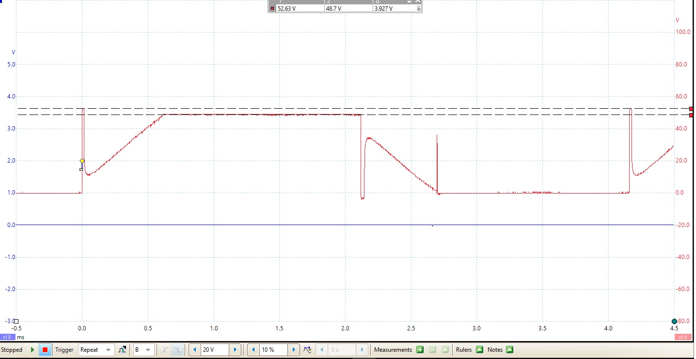

I have some hardware designed around the DRV8303 and I have the motors running smoothly, however as I increase PVDD (to less than 55V with a small Nema17 sized motor running no load even) the GVDD voltages not only drops down to 2.3V and stays there. It then gives me a fault and it also seems to be damaged permanently as even after trying to reset and leaving the power off the 11V does not come back.
I am using CSD19534KCS fets with the bottom set all connected to a common LSS for current measurement through a single shunt.
Below I have attached a Phase Waveform,
The first I noticed was the BEMF does look a little noisy but I put this down to the unshielded motor wires.
The second thing I noticed was the right hand slope being slightly lower than the left, this may be a slightly timing ussie so I will take a look at this in the programming.
Finally I noticed that the bottom of the phase drops down below GND.This is Odd and I am not sure how this has happened. There are no GND loops (that I can tell) an I am nnot sure if perhaps this is the cause for the GVDD failure?
I have also noticed that the charge pump fails as well as CP2 drop from around 10V to the same low 2.3V ish.
This has happened to a couple of PCB's now so it cant be a one off failure.
Thanks for you help
  • Hi Grady,
    What is the VM voltage in the image provided?
    How high was VM when the GVDD voltage dropped?

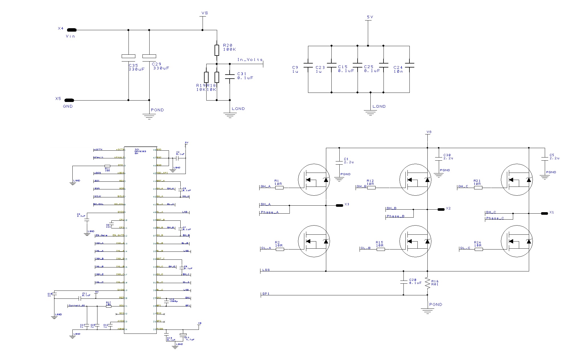

    Can you provide a schematic of the DRV8303 and the components around it?

    Below I have tried to capture all the important components to the motor drive, the smaller 5V caps are bypass and are mounted near their partner IC's.
    Let me know if you need more information, I want to try get this issue resolved today if possible.
  • Hi Grady,
    Thank you for the images. There are a couple of items to address:
    1) Can you please check if the thermal pad is connected to GND? This is required for proper device operation per the datasheet.
    2) How are you connecting LGND and PGND? If the voltage on LGND and PGND separate by too much, the low side FETs can inadvertently turn on, or the absolute ratings could be violated.
    The DRV8303 GND and the PGND should be the same ground to prevent these conditions.

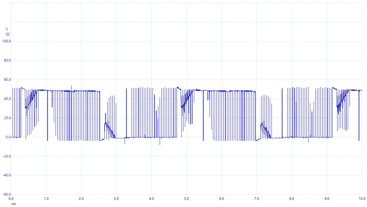

    However, the lower voltage trailing BEMF occurs with any motor that I try using either the DRV8303EVM or my pcb when the voltage increases. Below is a waveform of the DRV8303EVM running 48V on a larger motor.
    What I have noticed is that the DVR8303 has lower value gate resistors, dead time resistor and also has additional smoothing caps? (C87 & C88). My thinking is surely larger gate resistors and dead time is preferable (if we are having issues) but do I need the additional caps? My waveforms look fairly clean so I would not have thought so, but what do you think?
    Finally, from probing the DVR8303EVM its is clear that the its driving using the 6 PWM mode (not the 3 PWM) however the top and bottom drives are still synchronized (giving fast decay, 4Q operation). As I am only using a small PIC16F on this project I cant program this into the MCU. Do you think that perhaps as the GVDD is supplying the low side gates for a longer time period (I PWM the top gates) that maybe the charge pump cap cant work properly and hence making GVDD eventually fail on higher voltage? How would you suggest resolving this if it is the case? (perhaps larger CAP on GVDD?)
