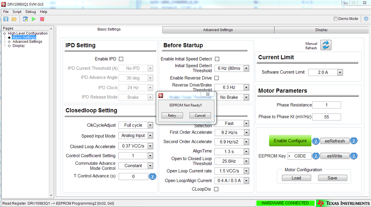

Hi we are working with the DRV10983 and want to store the parameter settings. If I try to programm the eeprom I got this Error message
I know that the supply voltage have to be over 24V for the DRV10983 but for the DRV10983Q the is not neseccary regarding the datasheet chapter 8.3.6 EEPROM Access
"Power up with any voltage within operating voltage range (6.2 V to 28 V)".
thanks

    It sounds like you have a good understanding of the process. If you click the retry button, does the message occur again? If it disappears after clicking retry, then that means the EEPROM was successfully programmed. You can check this by cycling power (turning it off and on again) and clicking the maunal refresh button on the GUI to see if the registers automatically populate with the settings that should have been programmmed into EEPROM.
    -Cole
  • Hello Cole, thanks for the answer, yes it disappears after I click retry. But if I restart the system (power supply on/off) nothing happens, the register have the default values (0x90 0x1048....)

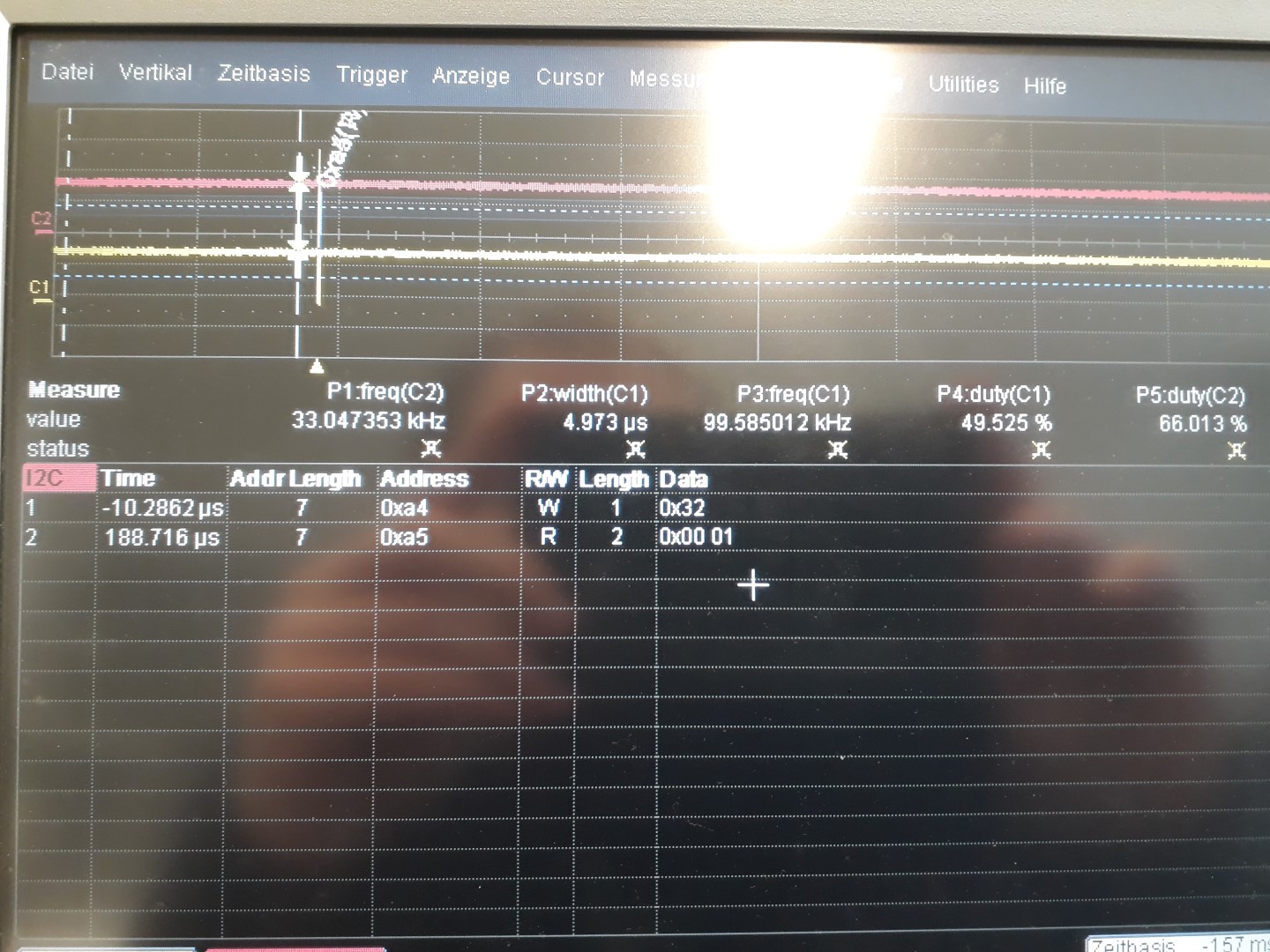

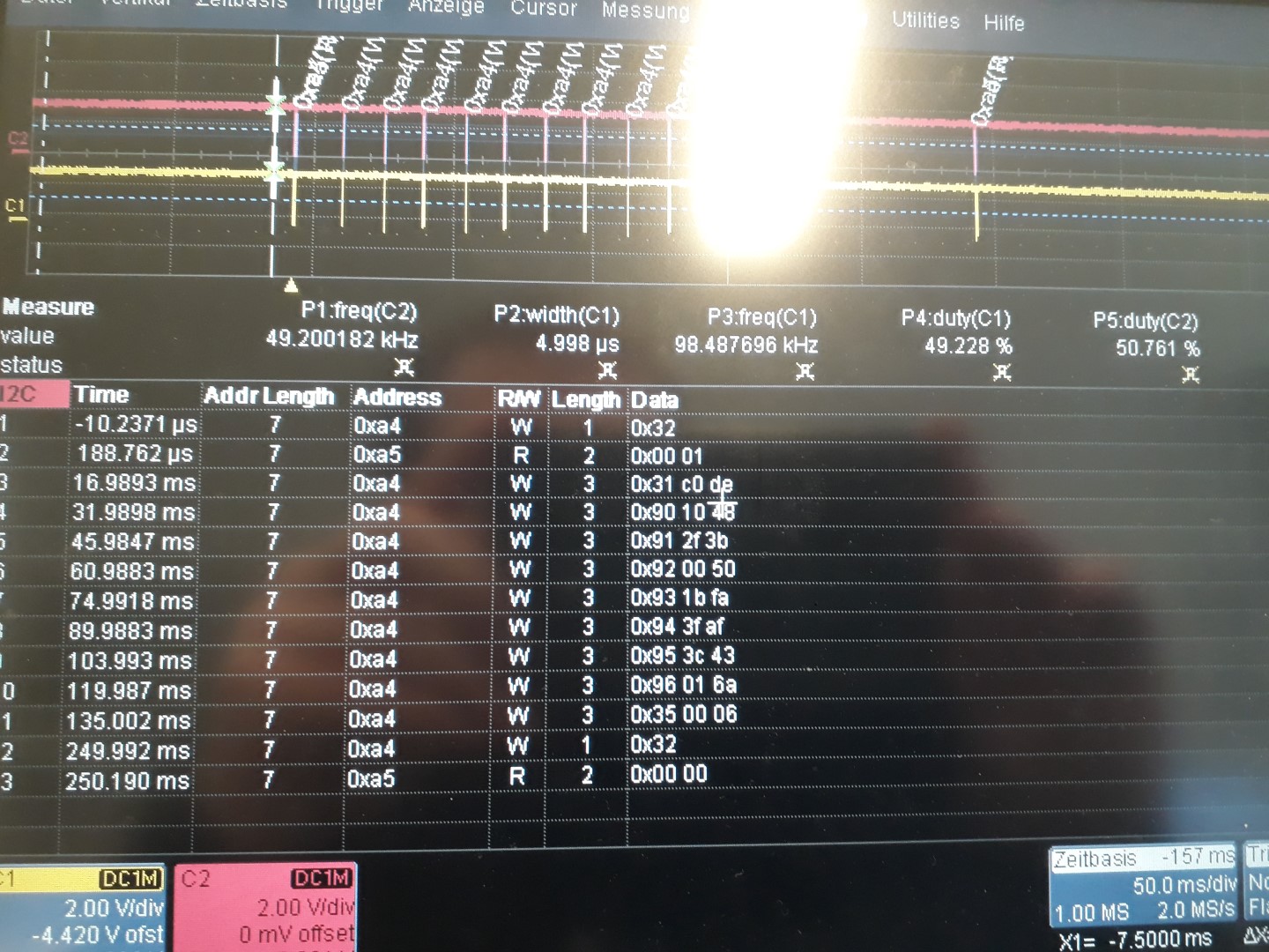

    I capture the I2C-Bus traffic here are the pictures
    this picture shows the traffic after I click "eeWrite" it seems the everthing is correct on the bus, the gui write 0xcode following with the
    config register and Register 0x35 with 0x6 which indicates that WRnEn is active and eeAccMode mass access enable. after that It reads reg 0x32 with 0x00 so eeprom is
    not ready and the gui shows the eeprom Not ready message after I click the retry button I capture this...
    it seems that now, the eeprom ready state is correct. but after power reset I read the default values...Have I to disable the
    Motor Operation before I write to the eeprom or something else?
    Jens
  • Hey Jens,
    Thanks for the data. I will start by clarifying that the motor should not be driven during the programming of EEPROM but you do not need to enable the "Disable Motor Operation" bit during the process.
    I have verified the process below, which is sounds like you are following, but please try this if it is different in any way:
    1. Power up the DRV10983-Q1EVM within the VCC operating range as described in the Out-of-the-box Quick Start Guide.
    2. Connect the USB2ANY and open the DRV10xx GUI with no errors
    3. Click the Enable Configure button turn green with no errors
    4. Set parameters as necessary
    5. Ensure the EEPROM Key says "C0DE"
    6. Click eeWrite
    7. Click retry on the message and ensure that it doesn't not appear again
    After this step, here's some things I'd like you to try:
    • Click the Save button in the Motor Configuration Box to save the .CSV
      • Open the contents of the file and see if the values match the newly programmed values of the EEPROM settings
    • Click the eeRefresh button
      • See if the changed settings in the GUI revert to default or stay the same (on the desired settings and value)
    • Power cycle like you did before, restart the GUI, and click the save button in the motor configuration box to save the .CSV
    The goal is to understand if the process isn't saving the EEPROM correctly or if power cycling is the problem.
    -Cole
