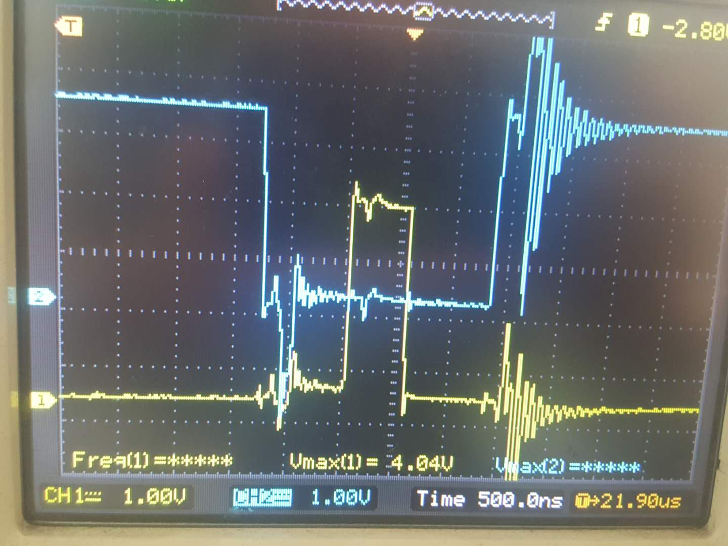

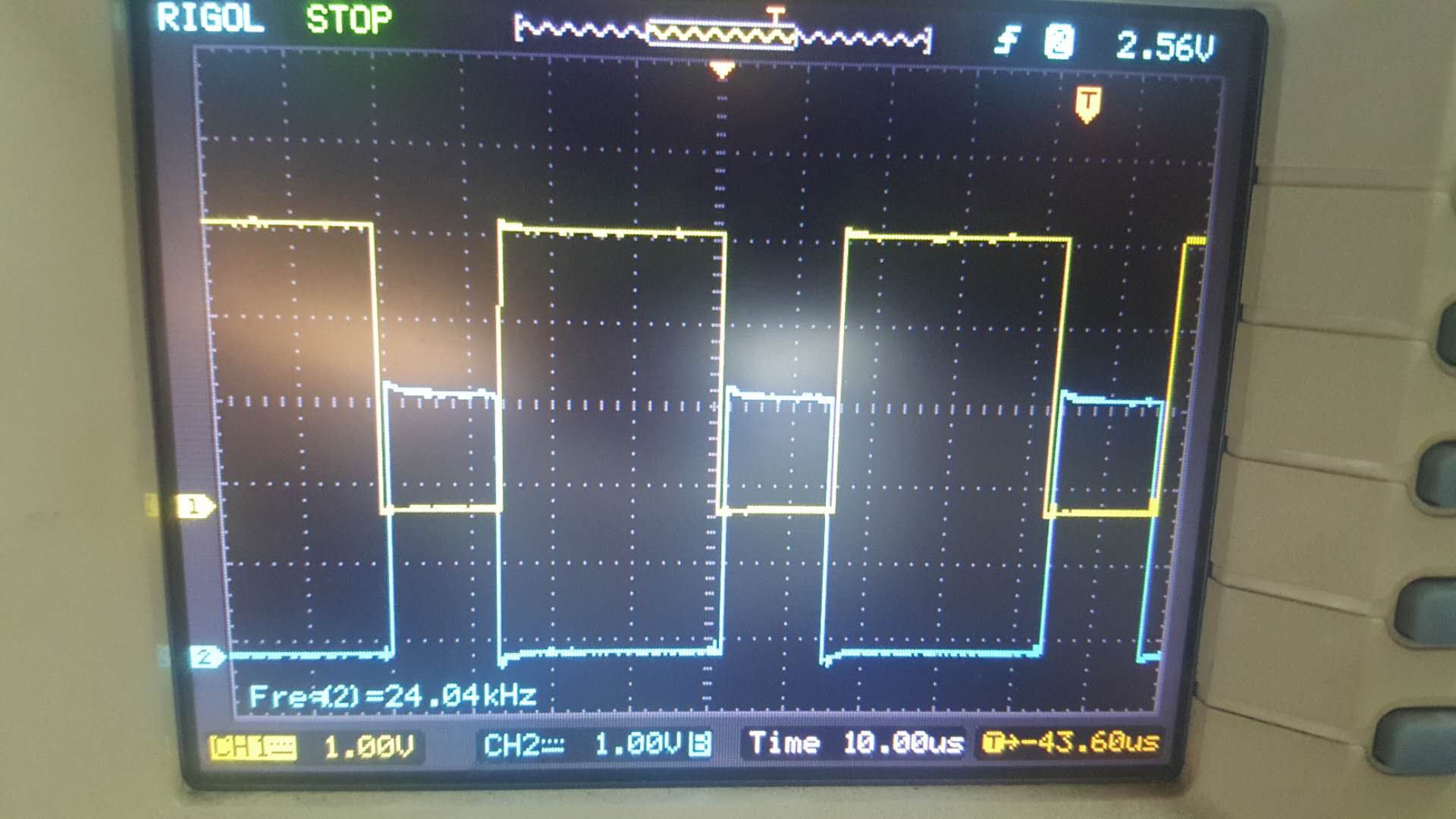

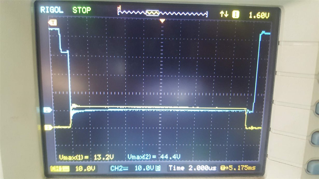

My motor driver is implemented using the DRV8323RX+CSD88584Q5DC
In the application, a mismatch between the gate drive signal and the PWM signal is encountered, causing the motor to start desynchronizing.
The waveforms measured using a normal MOS driver IC are as follows: (CH1pwm waveform, CH2 drive waveform)
Then measure the output waveform and PWM waveform of the DRV8323RX:
The settings for the DRV8323RX in the program are:
SPI_ReadWriteByte(0x1000);
SPI_ReadWriteByte(0x1BFF);
SPI_ReadWriteByte(0x27FF);
SPI_ReadWriteByte(0x2D59);
SPI_ReadWriteByte(0x3203);
What is the reason for the abnormality of the drive signal? I never found the reason.

    1. what's the normal MOS drive IC in first figure?

  • Hi Betty,
    1,The first figure of the normal MOS drive IC is L6389,from ST.

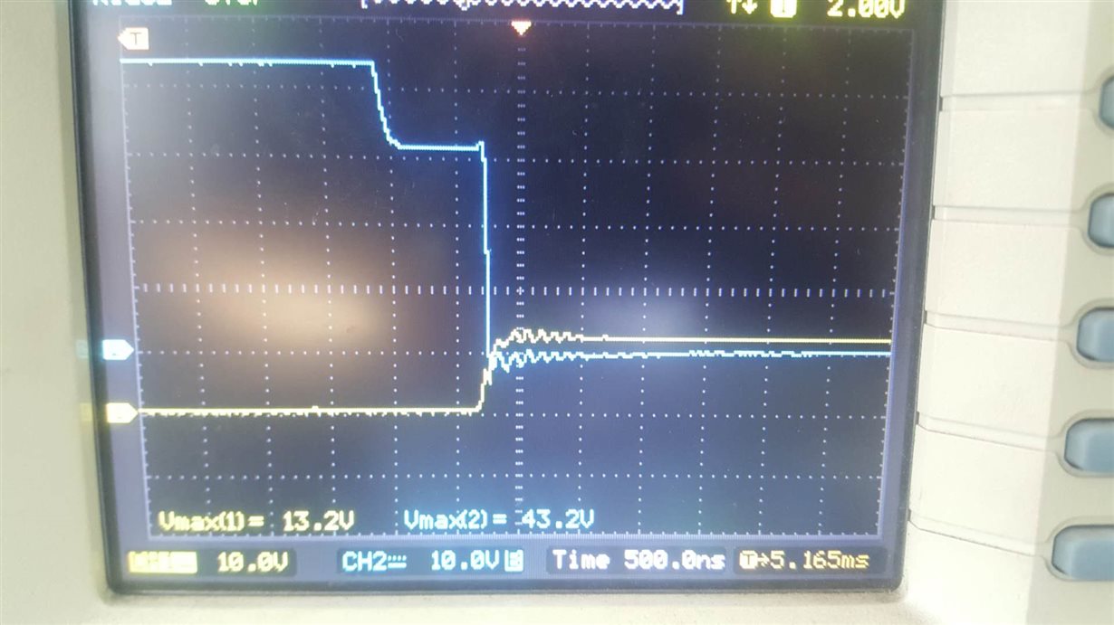

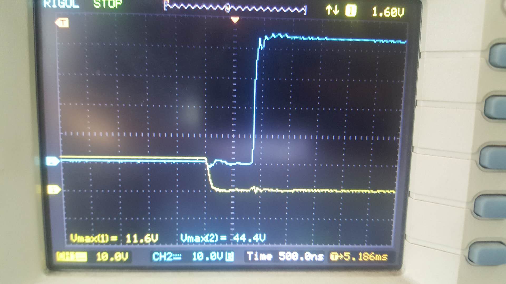

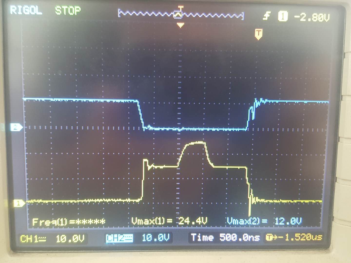

    and GHA waveform is this:
  • Hi Yingzhi,
    please measure the high side Vgs signal , Low side Vgs signal and deadtime.
    CSD88599Q5DC fall time is 2ns, so change the IDRIVEN to max, and measure how long the MOSFET need to turn off.
    Thanks.

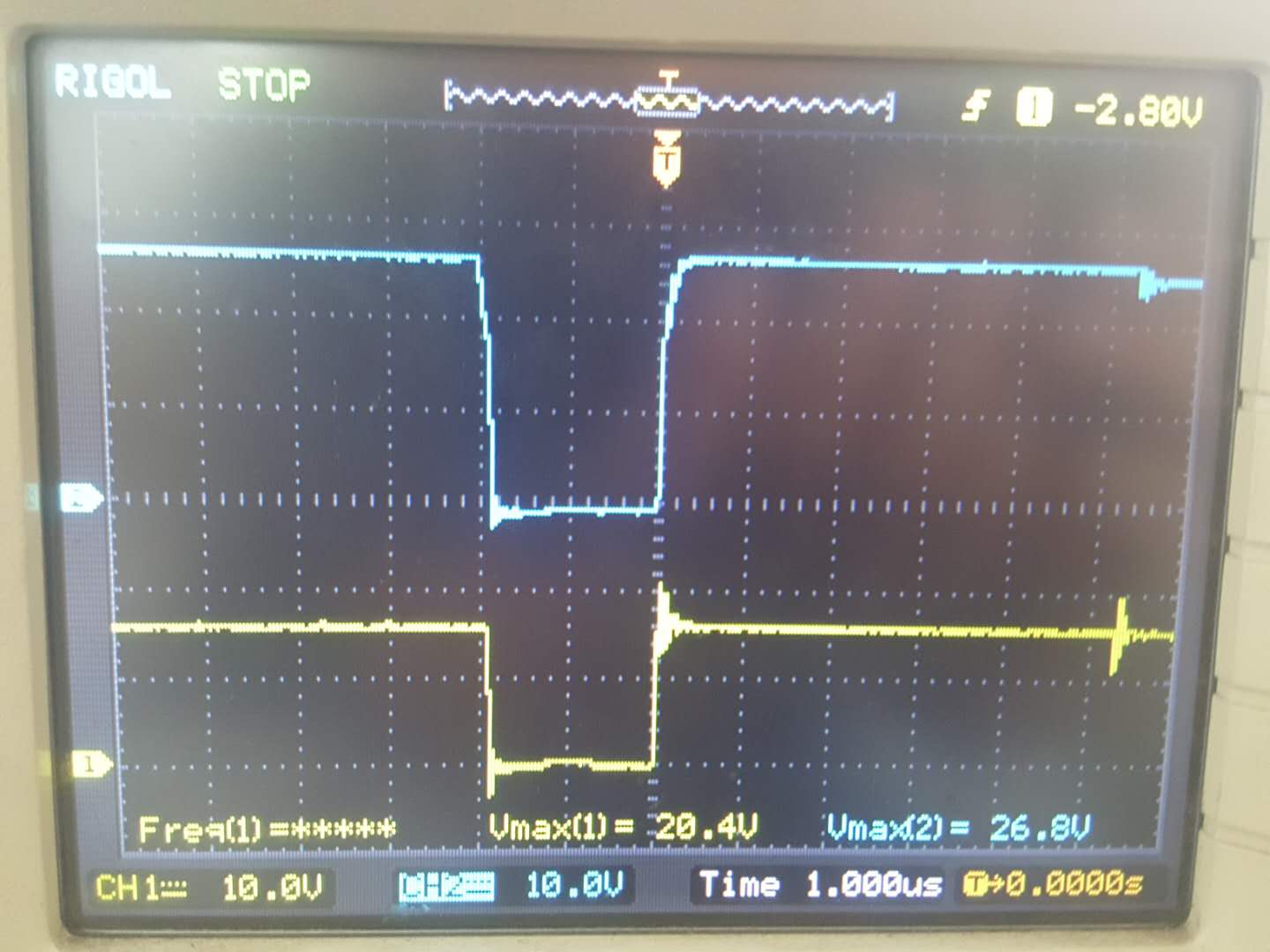

  • Hi Betty,
    I measured the signal about GHA and GLA at startup.
    Then also signals of GHA and MOTA.
    When the motor startup.Power start to go low.My power is 30V15A.

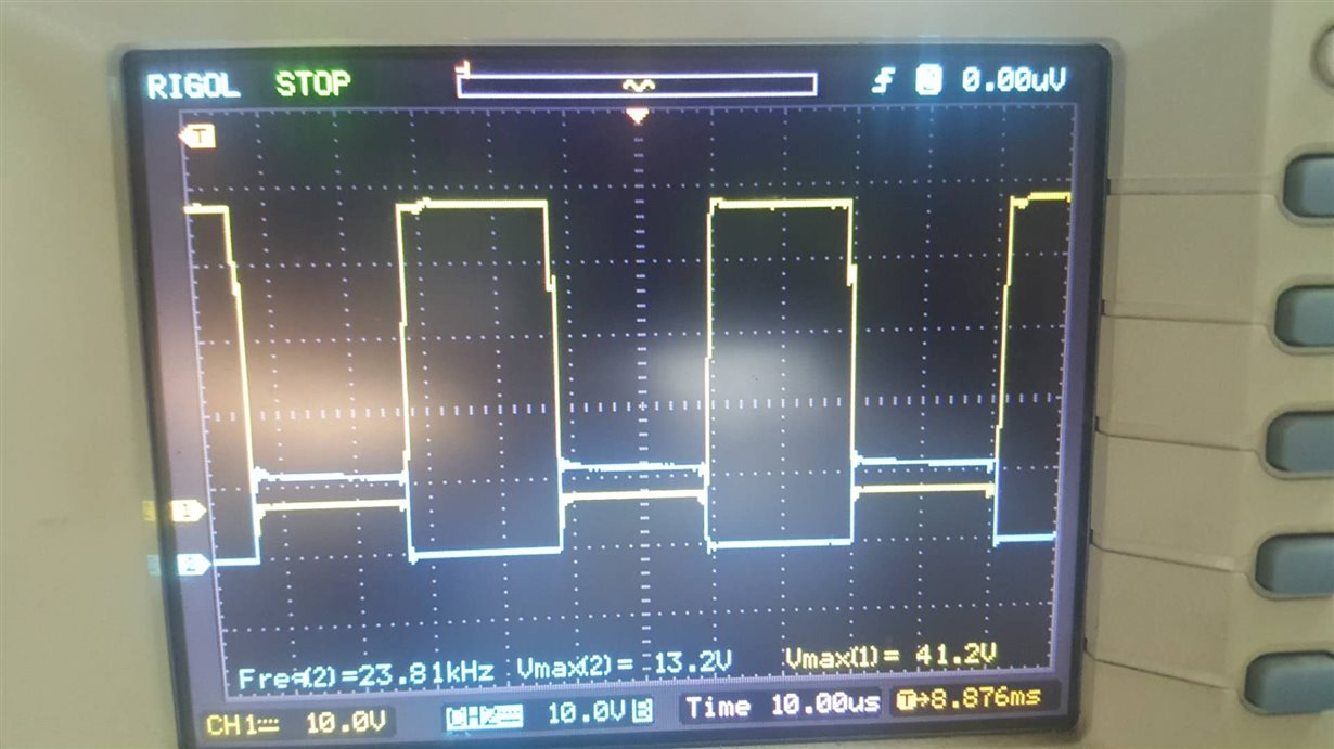

  • Hi Betty,
    I think I see an abnormal situation.  This is an incorrect waveform.GHB and GLB.
    The waveform is weird. And deadtime disappeared.  This wavefrom does not happen every moment.

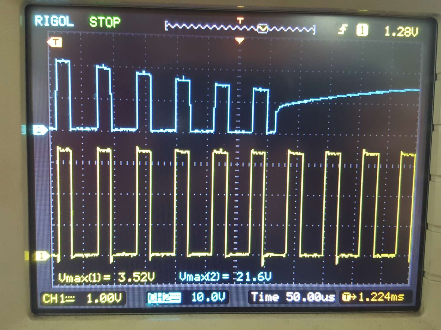

    Then I went to measure INHB and INLB.
     This is INHB and INLB wavefrom.
  • Hi Betty,
    DRV8323RS input logic high voltage is 1.5V. I thank it is the problem of the jitter of the input signal waveform of INHX and INLX.
    So I plan to change the PCB, Add to Res-Cap Circuits between MUC and INHX,INLX . Do you think this is feasible?
  • Hi Yingzhi,
    A better way is to change PCB layout to reduce this jitter. Usually there is not need RC circuit between MCU and DRV, because you can control the  MOSFET switch time by Idrive.

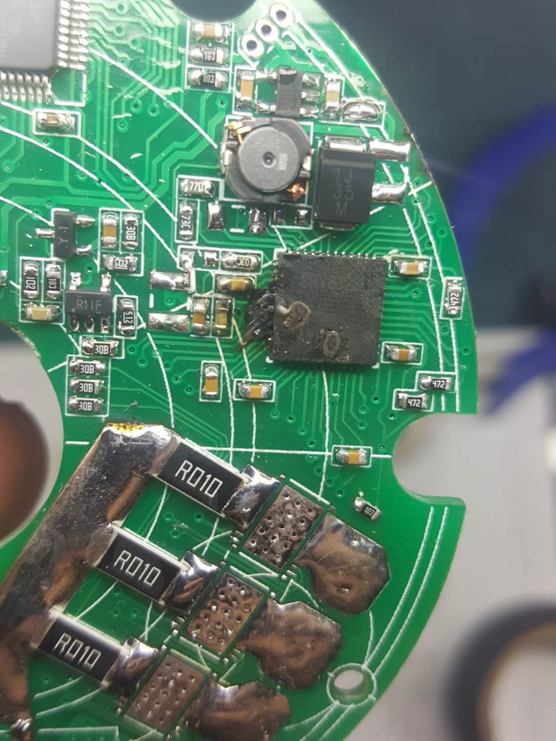

    I tried to start the motor several times. DRV8323 is broken. VM,VCP,VPH,BGND,AGND,DGND is connected.
    1uf/50V between VM and VCP,47nf/100V between CPH and CPL.
    I do not know why .
    Thank you for you help.
