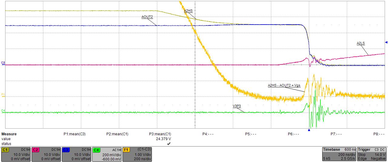

I'm working with the stepper Motor Driver drv8711 and I have disrupton on PCB. It seems to me, that the current regulation (switching on/off of the h-Bridge) is the cause.
Here some Picture:

Picture one shwos A1HS, AOUT1, A1LS and the current trough winding A.
The second picture shwos A2HS, AOUT2, A2LS and again the current trough winding A.
The decay mode was mixed.
First problem (first picture) during switching on Q1 and switching off Q3. Second and bigger problem (second Picture) during switching off Q5 and switching on Q7. The disruption is bigger in fast decay phase than in slow decay phase. Seems to me that there is short circuit behaviour.
Marco Larcher
I understand why you would go down the should circuit route. To verify if it is or isnt, can you zoom in on the first waveform disruption on your Q5/Q7 scope capture? There is no change in the half bridge signals except the current. If we can verify which signal is the first to trigger the disruption, we can see from part of the circuit the disruption propagates from.
I think this picture shows the problem better.
With increasing TDRIVEN, TDRIVEP, IDRIVEN, IDRIVEP you get worse results.
I think the problem is that...
... Q5 is switched off (A2HS = AOUT2), but still at 24V. After DTIME (dead time) the signal A2LS, Q7 is switching on. During the ramp of A2LS the voltage at AOUT2 drops. A2HS drops as well but a Little bit slower. Because of that, the Q5 is conducting. Means short circuit.

What is the lowest magnitude on the TDRIVE/IDRIVE parameters that the short circuit was noticeable from your end?
Dear Hector Hernandez Luque
TDRIVEN = 250ns
TDRIVEP = 250ns
IDRIVEN = 100mA
IDRIVEP = 50mA
With current magnitude it is possible to influence the effect.

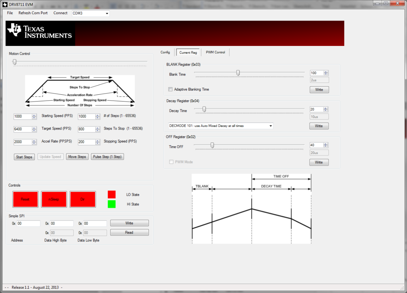

Can you send me a screen capture of the GUI home page with config open, then another with Current Reg and another with PWM Mode?

I see disruption in my scope captures, one is shown below. The noise propagates from the switching across the driving of the different coils of the motor. This issue can be mitigated with a series resistor, as indicated in the datasheet and in the image above. Now, if you do not want to add a series resistor to your application, you can provide to us your application specifications and I can recommend to you a device that does not have this noise propagation.
Hi Marco,
Did you also increase the dead time? What size of resistor did you use?
