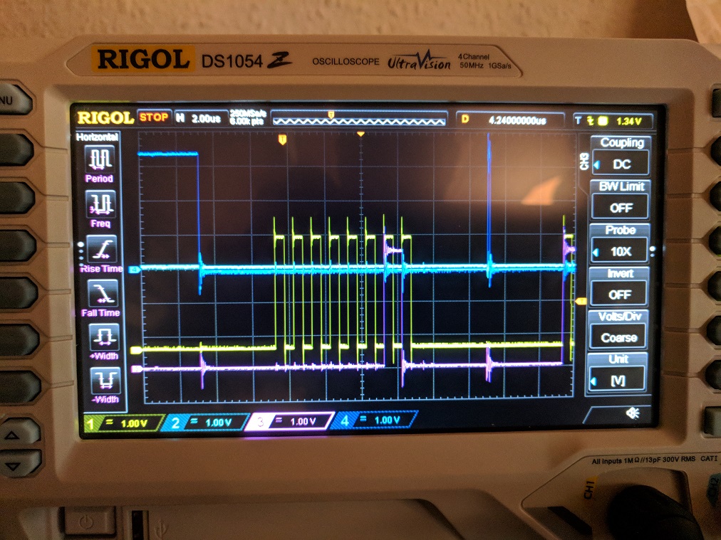

I am trying to SPI communicate to DRV8703-Q1 and I use following arduino SPI code:
void testSpi()
  usleep(10);
  // SPI WRITE
  vspi->beginTransaction(SPISettings(spiClk, MSBFIRST, SPI_MODE0));
  //byte stuff = 0b11001100;
  //hspi->transfer(stuff);
  digitalWrite(SS1, LOW);
  toTransfer = 0b11001100 << 8;
  toTransfer |= 0b11001100 ;
  vspi->transfer16(toTransfer);
  digitalWrite(SS1, HIGH);
  vspi->endTransaction();
  usleep(10);
I dont get any reply from device.
Picture of SPI Communication is attached -
channel1 - yellow : CLK
channel2 - light blue: SS (Slave select)
channel3 - pink: MOSI
channel4 - dark blue: MISO
Wht could be the problem? Any idea how to troubleshoot further?
regards

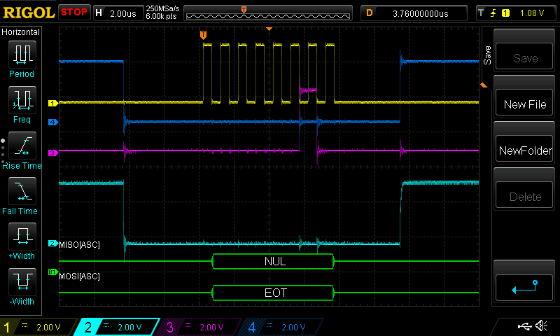

  • Hi Zhivko,
    Thank you for the updated scope capture.
    1) Pullup requirement is stated in the Pin Functions Description for SDO. "This pin is an open-drain output that requires an external pullup resistor." Please add the pullup. This can be done either externally or by enabling a pullup if the mcu has it available. The mcu pullup may not allow maximum SPI speed.
    2) Can you confirm channel 4 is nSCS, channel 1 is SCLK, and channel 3 is SDI? Is this is correct, you are trying to perform a read of address 0. Please read section 7.5.1 (SPI Communication) for the conditions of a valid frame.
    You need 16 clocks to perform a valid transaction
    nSCS should be low during the entire 16 clock sequence
  • Hi Rick!
    regarding 1 - OK found it now...
    regarding 2 - yes you got channels correctly
    Seems I need to persuade arduino to make 16 cycles SCLK of SPI transaction somehow.

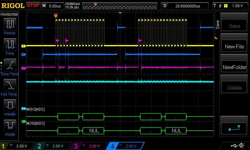

    And scope traces with pullup on SDO is:
    Sorry but isnt thi's 02x on MOSI line - second down on clk crossed with mosi line? 02x = 0010 binary - no ?
  • Hi Zhivko,
    "Sorry but isnt thi's 02x on MOSI line - second down on clk crossed with mosi line? 02x = 0010 binary - no ?"
    No it is not. The 8 bits from left to right should be 00010xxx. Please note Table 12 and 13 for the information.
    Once you fix the data on the MOSI line and keep nSCS low during the entire 16 bits, you should be able to read data from register 0x2.

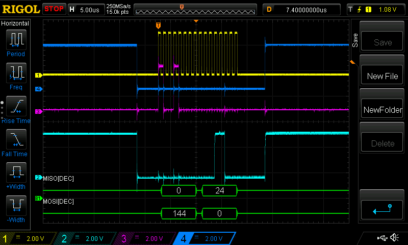

    Now I am trying 02x address as you see from picture:
    1 is READ than I have
    10010 Is READ from addres 2 (02x). I still dont get any reply - please see scope trace of first 16 CLK (two bytes) - next 16CLK is read of fault address:
  • So acording to my calculation (please correct me if I m wrong) read from addres 02x is 10010000 binaray or 144 decimal - and as you can see RIGOL also shows 144 decimal on MOSI line:
    Also I think that "Data is captured on the falling edge of the clock and data is driven on the rising edge of the clock." is OK since MOSI is forcing data on CLK down edge - so why there is no reply from  is wrong ?
    .... sorry - after turning on VM - 12V, I finaly got something back on MISO line:
  • Hi Zhivko,
    Glad to see you have it working. And you are correct; a read of address 2 should be 10010000.
