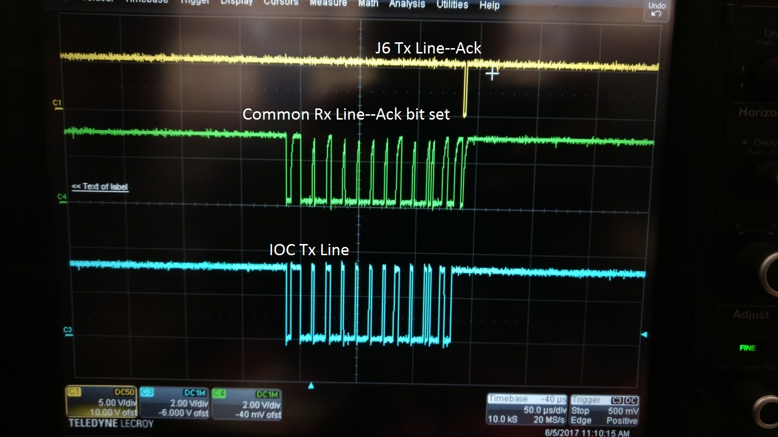

This Support is concerning an infotainment project relating to CAN communication with TI-J6 M4 Core.
Currently in our project the CAN messages are being seen over the  CAN Rx lines of J6 M4 Core. But, the J6 M4 core is not able to receive these messages meaning no interrupt is being triggered by the CAN controller.
We see that the J6-M4 core is  acknowledging  (Refer Image for more details where in the J6 Tx line is being acknowledged).the messages but unfortunately no interrupt is being triggered by the CAN CELL.
Even though the message is acknowledged by J6 it is not passed on to the upper layers, could you please help us out here on what could be the issue.
Thanks!

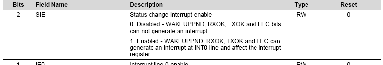

    I tried setting the SIE bit in the DCAN_CTL register to 1.
    Currently I'm seeing a value of 0x8000 in the DCAN_INT register, which according to the DRA7xx manual is DCAN_ES value is not 0x07.
    Also in the manual i find the below text
    "The value 0x8000 in the INT0ID field indicates that an interrupt is pending because the CAN core has
    updated (not necessarily changed) the Error and Status register (DCAN_ES). This interrupt has the
    highest priority."
    The DCAN_ES value what I see is 0x10 which means a message is received successfully.
    Does this value 0x8000 mean that interrupt is not triggered for some reason?

  • Hi Prashanth,
    No, 0x8000 should simply mean that not a message object triggered an interrupt but DCAN_ES register has changed. Interrupt must be triggered now, because you had enabled it in SIE.
    Interrupt handler must be aware of 0x8000, poll DCAN_ES for bit change, and perform needed actions.
    That is, currently DCAN should be generating interrupts on every Rx (and other events). But SW driver may not be aware of 0x8000 (ES) interrupts.
    You can either modify driver to show to you 0x8000 interrupt triggers, or setup message objects as required (the normal workflow).

  • Hi Prashanth,
    Here you are only sending message to DCAN not receiving. Right?
    What message are you sending to DCAN? Which is appearing on the bus in provided snapshot. I mean message details like ID, controls bit and data.
    Also please provide the mailbox configurations especially for Rx mailboxes for acceptance filtering.
