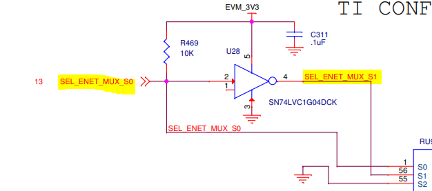

    Now its exporting and i am getting the folder. But the pin is not turning high, when i am setting it using echo 1 > /sys/class/gpio157/value
    Schematic of EXP_P1
    pasteboard.co/HtV3tLz.png
    i am taking GP5[29],GP5[30],GP5[31], But the GPIO is connected to a switch, which by default enables ethernet and GPIO will be disabled
    Schematic of switch
    pasteboard.co/HtV4Ncj.png
    Is it possible to toggle SEL_ENET_MUX_S0 from software? How can i change SEL_ENET_MUX_S0 so that Ethernet is disabled and GPIO is enabled?

    This change should not have affected LCD. But Ethernet could be affected based on how the lines are muxed between ports
    https://pasteboard.co/HtV4Ncj.png
    1) What happens when you change from "output-low" to "output-high" in the gpio hog settings of dts?
    2) Also, make sure you add entries in u-boot pin mux settings for GPIO5 pins you want to use.

  • Hi Ganesh,
    None of the Ethernet port will work with the change to SEL_ENET_MUX_S0 for selecting GPIO5 pins.
    Changes to SEL_ENET_MUX_S0 also changes SEL_ENET_MUX_S1.
    SEL_ENET_MUX_S1 controls the MDIO pins and MDIO pins are needed for any Ethernet port to work.

  • Hi Vishal,
    As per schematics the three pins GP5[0], GP5[1] & GP5[17] is connected to EXP_P2. These three pins are connected directly to SoC, so do we need to do any Mux changes or can we directly export it as gpio and start using it.
    Schematic of EXP_P2 with GPIO's highlighted
    pasteboard.co/HvUlrR4.png
    Schematics of GPIO's connection to soc
    pasteboard.co/HvWybJT.png
    pasteboard.co/HvWyhVG.png
  • GP5[0] and GP5[1] have no conflict, You just have to update corresponding pinmux in boot loader for choosing these GPIO pins over mcasp1_aclkr and mcasp1_fsr pins. Similar to changes shown earlier - https://e2e.ti.com/support/arm/automotive_processors/f/1020/p/701154/2618639#2618639
    But, in this case you have to add new entries for these pins.
    GP5[17], I am not sure, this pin conflicts with RMII_MHZ_50_CLK, which could have impact on Ethernet.
    You could try changing pinmux of RMII_MHZ_50_CLK to gpio5_17 and check if Ethernet is still functional.
