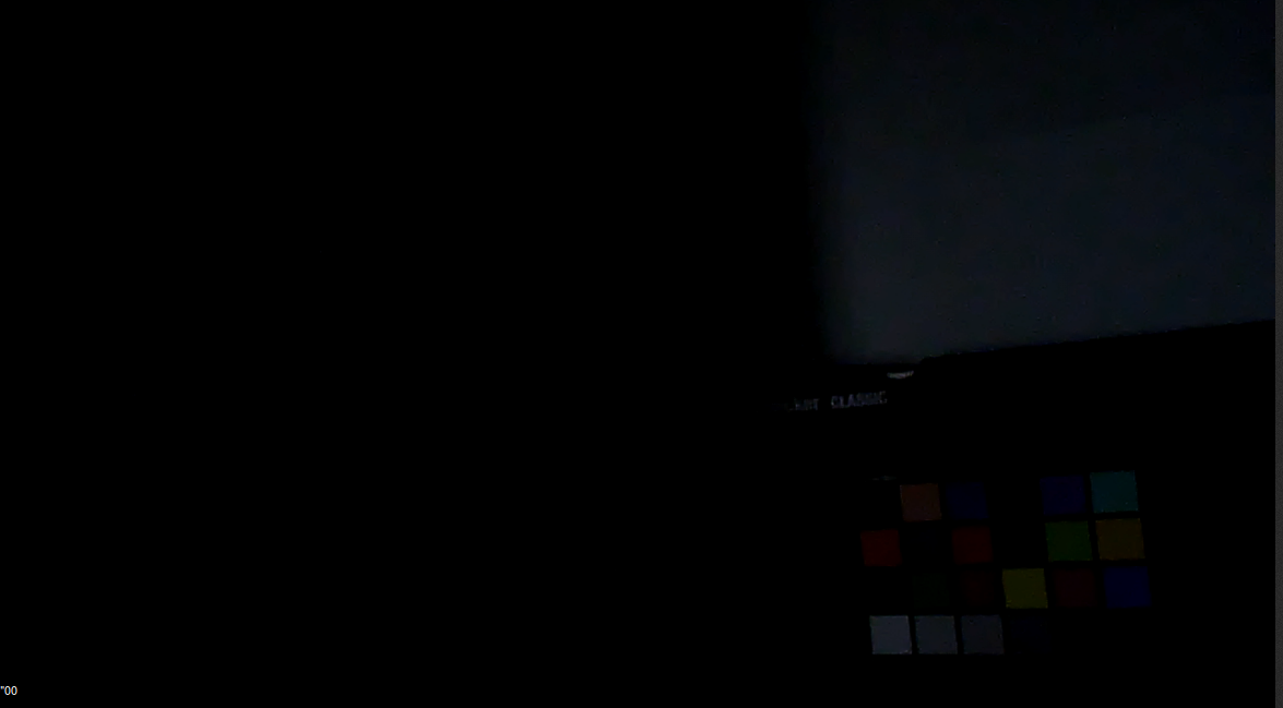

    Please check below images captured in our lab. These are captured with GLBCE ON and OFF for same scene.
    GLBCE OFF
    GLBCE ON
  • GLBCE purpose is not lowlight tuning. It is used to improve dynamic range.
  • Yes. We need to improve the dynamic range too. Then only we can handle a scene with highlights and shadows right ? We need to handle headlights falling on camera and dark areas in a scene (for low light and night). This is also a dynamic range scene right ?
  • Yes, but there is very little GLBCE can do in linear mode. Please enable 2-pass WDR mode.

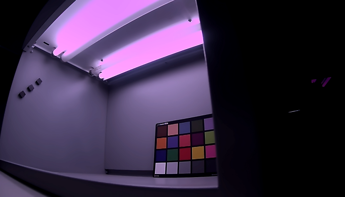

    We enabled GLBCE by making pPassCfg->openPrms.isModuleReq[VPS_ISS_ISP_MODULE_GLBCE] = (UInt32)TRUE; in IssM2mIspLink_drvCreateDrv() function. GLBCE control 0 register (0x52051008) is 0x00000009 while streaming; which means GLBCE enabled. Is this changes alone is sufficient for GLBCE ?
    1. For WDR mode (which having GLBCE enabled) we could see pPassCfg->ispPrms.glbcePath = VPS_ISS_GLBCE_PATH_ISP; instead of pPassCfg->ispPrms.glbcePath = VPS_ISS_GLBCE_PATH_DISABLED;
    Is this needed for GLBCE in 12-bit also ? After changing this GLBCE_PATH_ISP; GLBCE control 0 register (0x52051008) is 0x00000009 when streaming starts later it changes to control 0 register (0x52051008) is 0x00000008 ; which means GLBCE disabled. A pink color observed around light sources. But the headlight in dark environments looks better.
    2. Shifting up input before GLBCE and shifting down by 4-bits after GLBCE is handled for WDR mode and monochroma mode only. Is this needed for linear mode as linear mode has 12-bit data ?
    /* For monochroma path and 16bit WDR mode, it is required to shift up the input before GLBCE and shift down by 4 bits after GLBCE. */
    if ((ISSM2MISP_LINK_OPMODE_12BIT_MONOCHROME == operatingMode) ||
    (ISSM2MISP_LINK_OPMODE_1PASS_WDR == operatingMode))
    Pink color disappeared after adding ISSM2MISP_LINK_OPMODE_12BIT_LINEAR mode here for shifting i/p and o/p . But light sources in dark environments (dynamic range scene) become worse as more spreading observed.
    3. This picture is captured after enabling following.
    pPassCfg->openPrms.isModuleReq[VPS_ISS_ISP_MODULE_GLBCE] = (UInt32)FALSE;
    Having a pink tint.
