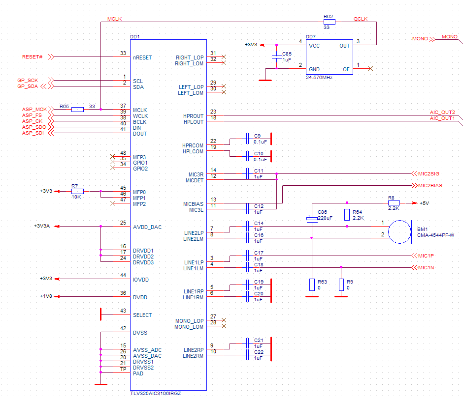

HI Everyone. I'm trying to design a product that'll use the sitara proc and i'm trying to base a prototype simply on the starter kit. Its got everything except audio in. What the easiest way to get 2 audio channels into the board. I need a fully duplexed system so that's another concern.
  • Hi Mustafa,
    The Starter Kit has an audio codec, TLV320AIC3106 on board (schematics page 14). If you are designing your own schematics you can refer to the documents on the codec product page (http://www.ti.com/product/tlv320aic3106) for reference. If you need to patch the Startet Kit for prototyping, you will need to connect to the Line In or Mic inputs, depending on what signal input you need. These can be accessed via the capacitors connected to them (capacitors will probably need to be removed). You can find the Starter Kit board design files at this link: http://processors.wiki.ti.com/index.php/AM335x_StarterKit_Board_Design_Files. The PCB file is in Cadence Allegro format, there is a free viewer available on the Cadence web site.
    I want to connect Mic input to Sitara AM335xsk Revision 1.2B
    i have patched a board by removing capacitor C164 and C166
    Connect MIC3R of U31(TLV320AIC3106) to Condenser MIC using 0.47uF capacitor
    and connect MICBIAS pin to Condenser MIC using 2K resistor
    as referred by TLV320AIC3106 data sheet page 18 Figure 13.
    But still MIC is not taking input
    I have tested in Linux-sdk using arecord
    and Sound recorder in Android
    Also try to detect register status of Codec IC to check configuration for MIC input
    but not able to get I2C bus as it is always busy and not giving access to read or write device

    Is Codec IC is properly configured by drivers to take MIC input
    Please suggest how to move further

  • Hello Vladimir,
    What SDK are you using?  What modifications did you make to the kernel to reflect your hardware changes?
    "Also,  is it possible to set up ALSA to AIC3106 capabilities to forward line inputs directly to outputs through the mixer? One of the desired functiond of the end product is to switch output between two inputs while capturing their data to LAN."
    You should be able to accomplish this by editing your ALSA configuration in your filesystem.  See this page for more details.
    By the way, our SDK 7.0 Linux Audio page has lots of details that may help you.

  • Hello Vladimir,
    To test this in linux, you will have to modify the kernel to be able to activate this functionality.  If you are using SDK7.0, most of these changes will occur in the Device Tree file, although you may have to edit sound/soc/davinci/davinci-evm.c a bit.  Check the Board Port section of this page for more details: http://processors.wiki.ti.com/index.php/Sitara_SDK_Linux_Audio
    For SDK 6.0, you would need to edit the am335x board file and sound/soc/davinci/davinci-evm.c.  This isn't an exact example, but this e2e forum post shows where the changes would need to occur: http://e2e.ti.com/support/arm/sitara_arm/f/791/t/194645.aspx
    Pretty much what you would need to do in each case is set the Starter Kit to have the same setup as the General Purpose EVM, which uses both audio input and output.
    Josh

  • Hi Vladimir,
    The default linux build running on the Starter Kit will not have any ALSA audio inputs configured with the McASP, so none of the audio utilities will know about any audio recording hardware.  If you type "arecord -l", you should see a message about "No soundcards found."
    However, if you ran that same linux image on the General Purpose EVM, linux would be able to detect audio input hardware, and so arecord would see a properly configured device available.
    Josh

    Unfortunately, it would not be possible.  If you are using SDK 6.0, in the arch/arm/mach-omap2/board-am335x.c, you can see the following lines of code relating to the McASP setup for Starter Kit:
    static u8 am335x_evm_sk_iis_serializer_direction1[] = {
    	INACTIVE_MODE,	INACTIVE_MODE,	TX_MODE,	INACTIVE_MODE,
    	INACTIVE_MODE,	INACTIVE_MODE,	INACTIVE_MODE,	INACTIVE_MODE,
    static struct snd_platform_data am335x_evm_sk_snd_data1 = {
    	.tx_dma_offset	= 0x46400000,	/* McASP1 */
    	/*.rx_dma_offset	= 0x46400000,*/
    	.op_mode	= DAVINCI_MCASP_IIS_MODE,
    	.num_serializer	= ARRAY_SIZE(am335x_evm_sk_iis_serializer_direction1),
    	.tdm_slots	= 2,
    	.serial_dir	= am335x_evm_sk_iis_serializer_direction1,
    	.asp_chan_q	= EVENTQ_2,
    	.version	= MCASP_VERSION_3,
    	.txnumevt	= 32,
    	.get_context_loss_count	=
    			omap_pm_get_dev_context_loss_count,
    The kernel is only being configured to use TX when Starter Kit is detected.
    Josh

  • Actually, in that same board fiel, there are structures that are initialized to do that with the General Purpose EVM:
    static u8 am335x_iis_serializer_direction1[] = {
    	INACTIVE_MODE,	INACTIVE_MODE,	TX_MODE,	RX_MODE,
    static struct snd_platform_data am335x_evm_snd_data1 = {
    	.num_serializer	= ARRAY_SIZE(am335x_iis_serializer_direction1),
    	.tdm_slots	= 2,
    	.serial_dir	= am335x_iis_serializer_direction1,
    	.txnumevt	= 32,
    	.rxnumevt	= 32,
    So you'd just have to reuse these configurations for the Starter Kit structures.
    Josh

    Please, note that
    1) this was dumped using our schematics originally derived from EVM but with some modifications. Here is an our schematics.
    2) mixer is too complex and I allways forget all the things that should be tuned to get good signal with minimal noise. The current configuration being dumped was made manually so there was some additional noise. But I could record the file from built-in microphone BM1 and then play it back. I used these commands:
    arecord -f dat test.wav  for recoring, and
    aplay test.wav for playback
    Now the part of the schematics around AIC.
  • Hi Vladimir,
    Thanks for sharing this, and for the prompt reply.
    I found out the rootcause of my issue. I did not have any pull-ups on the lines (I am using an external mic). So stupid of me :-) Anyway I have everything working now. I'll use the Codec register settings to check your config and see how well it is aligned with mine. I am now targetting perfect audio quality on the line-in inputs.
    Thanks again,
    Gregoire
