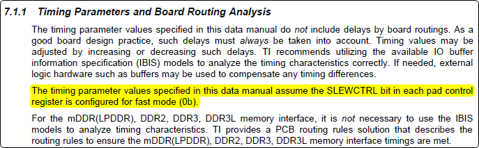

    The data manual specifies that the timings given all apply to fast mode.

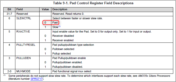

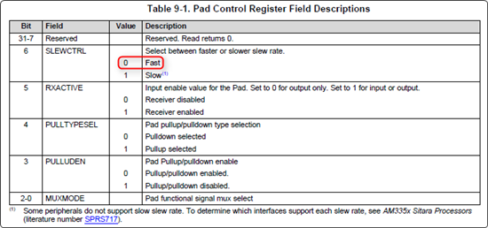

    So in short, you want to use fast mode all the time.  And it just so happens that the way the register is defined, a value of 0 corresponds to fast mode:
    That means for all of the pins that are NOT specifying fast mode, you're actually getting it regardless...

  • So what you're saying is that MDIO Data:
    0x148 (PIN_INPUT_PULLUP | SLEWCTRL_FAST | MUX_MODE0)    /* mdio_data.mdio_data */
    Is explicitly setting the slew control to fast, where as MDIO clock:
    0x14c (PIN_OUTPUT_PULLUP | MUX_MODE0)           /* mdio_clk.mdio_clk */
    Is implicitly setting slew control to fast based on the fact that the value "0" is used for "fast" in 9.3.1.50. That's what you're saying?
    The note in the description of table 9-60:
    Says that's not guaranteed to work.. I didn't check all the pad settings in the data manual yet, and based on the linked forum exchange saying that TI doesn't test with slow rate, it sounds like a safe assumption... but it's still an assumption.
    Am I misunderstanding anything here?
    We overwrite whatever is in there.  Reset value doesn't matter in this case.
  • For those reading from home, note that SLEWCTRL_FAST is misdefined as (1 << 6) in the current upstream Linux sources, so the first configuration above is actually setting it to slow.  See https://lists.yoctoproject.org/pipermail/meta-ti/2014-September/005211.html for more details.
