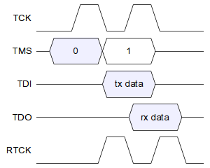

    As for this diagram:
    Matthijs van Duin said:
    Note that this much roundtrip delay, with RTCK being 180͏° out of phase with TCK, is quite extreme. In this case you obviously cannot sample TDO on the rising edge of TCK as the JTAG spec requires, though sampling on the falling edge of TCK or the rising edge of RTCK will work fine.  This timing is what I observed when operating at 30 MHz (on a custom DM814x based board), and may explain why they specified a much lower max clock rate in the datasheet.  Pretty picture to go with it (this is with ICEPick's "advance RTCK timing" option disabled, its default setting):
     (click for full size)
    (At least some of the cross-talk-like "wobble" is due to measurement error, possibly because I connected the ground leads of the probes together to a single ground of questionable quality.)

    If by the TDO behavior you mean the delay from TCK to TDO/RTCK, that's definitely just internal (gate+wire) delays when only ICEPick and/or one or more DAPs are in chain. The ~15 ns I saw on the scope is quite reasonable for that. Things are different of course when an older (pre-Cortex) ARM core is in the chain since then there would be additional delays due to resynchronization to the core's clock (adaptive clocking is typically used in that case to ensure reliable operation).
