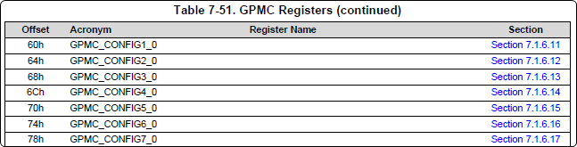

  • Which chip select is this for?  Can you use devmem2 to print out all the corresponding GPMC_CONFIGx registers?  Please include the complete printouts so I can see the addresses you're reading.
    I suspect that somehow the GPMC may have had its configuration over-written and that you're not in the 8-bit non-multiplexed mode as you expect.
    Also, what address are you accessing to read from the GPMC?  If for example your math is incorrect with respect to how you're performing the accesses then the GPMC might be using the configuration from another chip select space.  Can you confirm that the expected CSn signal is asserted when performing the access?

  • Is bit 1 of the GPMC_CONFIG (0x50000050) register set? If the LIMITEDADDRESS bit field of the GPMC_CONFIG register is enabled, A27-A11 are forced to 1.
  • I think this must be the.... BINGO!
    I will verify this and post the result.
  • Took me some time to update this status.. to busy with other things.
    Yes, I confirm this is the answer to my problem. It works now.
    Thanks Brad.
