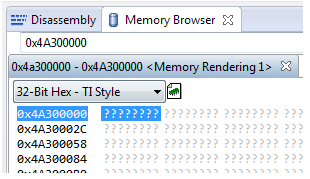

    Have you run any GEL files?  Can you access any other memory areas?  Or does it only hang with the PRU memory area?
    Note that when accessing the PRU memory, the PRU clock needs to be first enabled.  Otherwise, the Memory Browser will show question marks.
    Melissa
  • Please see #2 in my OP. Can't get by the memory issue. The ARM gel init runs when I connect to the ARM. I can see PRU memory (at least I think I can). I have not specifically enabled the clocks.
    I can display and load PRU memory with my binary file and see the memory contents in the window change. CCS6 locks up when I try to display the disassembly window.
