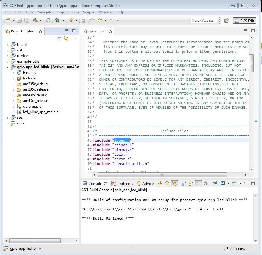

  • Jinu
    To support various devices and boards plus provide modular packaging of the abstraction layer, tools and utilities the SDK starterware examples draw upon several API and include files.
    The starterware user guide gives an overview of the starterware software architecture.
    The location for this document is {IA_SDK_HOME}\starterware\docs.
    As an example, the starterware gpio_app_led_blink example project in {IA_SDK_HOME}\starterware\examples\gpio\led_blink draws upon six dependent projects.
    These must be imported into the workspace when building the gpio_app_led_blink project.
    These are:
    board
    dal
    device
    example_utils
    soc
    utils
    David

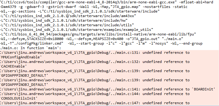

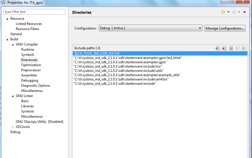

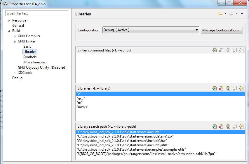

    To create a new project based on SysBios, i included the following header files in include path.
    But when i try to compile the project, i am getting the following error,
    i think its a problem with linker . i tried to add the path in linker as shown below. but still its not working
    Can you please help on this?
  • Hi Jinu
    The error is occurring during the link phase. This can be resolved by importing the board, dal, device, example_utils, soc, and utils Starterware projects in the workspace. These projects are built along with the gpio_app_led_blink project.
    David
  • Hi David,
    i was able to run the example Programs.
    But my concern is that I want to make an independent project not the example code.
    I created a new project in that i copied the GPIO toggling program(main.c file).
    I also opened the board, dal, device, example_utils, soc, and utils Starterware projects in the workspace.
    But still getting the above mentioned error  like "undefined reference".
  • Hi David,
    To create a base project for AM437x , what are the steps to be followed?
    i tried to create a project as follows.
    using New->CCS project option, we created a project based on AM437x.
    i added gpio_app.c file from example project to this newly created project.
    Tfollowing include paths are added .
    C:\ti\sysbios_ind_sdk_2.1.0.1\sdk\starterware\include
    C:\ti\sysbios_ind_sdk_2.1.0.1\sdk\starterware\include\hw
    C:\ti\sysbios_ind_sdk_2.1.0.1\sdk\starterware\include\utils
    C:\ti\sysbios_ind_sdk_2.1.0.1\sdk\starterware\examples\example_utils.
    Now if i want to toggle an LED pin using this , what all are the files need to be added?
    How can we link files in starterware dal folder(.c files) to this project?
