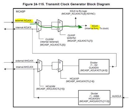

    1. sysclk in the davinci-evm.c driver file does refer to the AHCLK.  It’s passed to the driver so the BCLK divider can be properly calculated
      #Q2: Is it possible to drive only a bit clock and frame sync to the McASP and utilize the existing audio Linux drivers and userspace applications (gstreamer) or are significant changes needed to enable this setup?
      I’m afraid I don’t understand the question.  Could we get more details? If possible, what usecase they’re trying to enable.
      #Q3: Can the sound driver operate without a high-speed clock source (sysclk) present on the McASP/Sitara?
      Yes, it’s possible to operate without the high-speed clock, only if McASP is slave (i.e. analog audio codec provides the BCLK)
    1. In the diagram below, the external ACLKX is the bit clock that would be used if AHCLKX is not wanted.
    Yanko

    1. There is no requirement to provide AHCLKX.  Ultimately that's just an option to derive ACLKX, but as Yanko showed in the marked up diagram, it is possible to directly provide ACLKX from the pin, which is what you will need to do.  This is programmed by configuring ACLKXCTL[CLKXM]=0.  The CLKXM bit is what controls the mux shown in Yanko's diagram.
    2. There's a similar concept that applies to the frame sync.  Please see Figure 22-19 "Frame Sync Generator Block Diagram" in the AM335x TRM.  If you wish the frame sync to be provided from the external device as an input to the AM335x then you must program AFSXCTL[FSXM]=0.
    3. If ACLKX and AFSX are inputs to the McASP, make sure that you configure PDIR[ACLKX]=0 and PDIR[AFSX]=0.
    4. Make sure that the pin mux registers for ACLKX and AFSX have both configured bit 5 (rxactive) to 1 (enabled).  Otherwise, the signal will be unable to propagate from the pad to the mcasp.

    The sysclk rate is irrelevant when McASP is in slave mode.  Customer could just set it to 0. Register - ACLKXCTL[5] CLKXM - Transmit bit clock source bit.
    0x0 = External transmit clock source from ACLKX pin.
    The way the machine driver indicates that McASP is to be slave (hence the codec is master) is through the SND_SOC_DAIFMT_CBM_CFM format flag, which the customer appears to be already doing properly.
    Their call to set clock direction is correct:
    ret = snd_soc_dai_set_sysclk(cpu_dai, 0, sysclk, SND_SOC_CLOCK_IN);
    The bit clock divider call is not relevant when McASP is in slave mode, please refer to the diagram I sent in my previous email:
    ret = snd_soc_dai_set_clkdiv(cpu_dai, 1, sysclk/bclk_freq);
    See register ACLKXCTL[0:4] CLKXDIV - Transmit bit clock divide ratio bits determine the divide-down ratio from AHCLKX to ACLKX. 0x0 = Divide-by-1.
    In conclusion - It seems to me that the customer settings are correct.
    Yanko

    Obviously, from ACKXCTL it seems that bit 5 (CLKXM) is not set active to 1, so, that is a concern!
  • PEleph said:
    For ACLKXCTL (offset=B0h) Transmit Clock Control Register
    root@am335x-evm:~# devmem2 0x4803C0B0
    /dev/mem opened.
    Memory mapped at address 0xb6f3f000.
    Read at address 0x4803C0B0 (0xb6f3f0b0): 0x00000000
    There's no concern here.  Bit 5 is supposed to be 0.  That corresponds to external transmit clock source.
