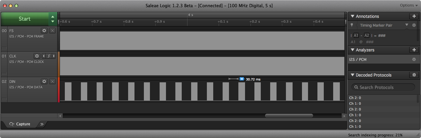

I am trying to stream audio to the AM335x EVM.  I was having problems with network performance, especially over Wi-Fi.  The TI employee who is helping me in my post in the Wi-Fi Forum said it might be a resource issue...however this system should be able to handle this as it is a faster processor than that used in the Streaming Audio Reference Design.
I have now removed the daughterboard from the EVM and am working with the McASP1 port directly.  I plan to hook up an external codec, but first I am debugging the issues using a logic analyzer and software based I2S decoding.
I followed this example to create a new driver for my codec and am successfully decoding the I2S data and converting it into a .wav file and playing it back on my laptop.
The problem is that whenever I try to stream across a network interface - even loopback via localhost - there are 30.72ms gaps in my I2S data stream.  The clock and frame keep going, but the data line stays low during that time.
I streamed a sine wave and I can see that the samples are being separated - not dropped...in other words if I were to manually delete the 30.72ms gaps, the sound would be correct.
I've also tried streaming locally while exercising the Wi-Fi module using iperf to see if it was a contention or resource conflict issue, but that doesn't seem to be the case.  So it seems to be something specific to using GStreamer from a network interface (even loopback) to the audio device.
Here is a picture of the issue on the logic analyzer:

    Can you post a zoomed in capture that shows your clock and frame sync more clearly? From your sine wave above it appears like you are trying to use 32 bit data at 96kHz sampling rate. Is this correct?
    What bit clock rate and what frame sync frequency are you trying to get and what are you actually seeing on the scope capture?
    Jason Reeder
    I don't have the zoomed in picture at the moment, but I was using 24-bit data at 96kHz.  Although I also went lower to see if it was a bandwidth / data transfer issue too.  The problem scaled down even to 8kHz.  The correct number of bits per frame etc were coming out when I made those changes.
    Andrew

  • My working assumption after seeing your scope capture was that the frame sync frequency may have been faster than the sampling rate of the audio which caused the gaps in the output until the next sample was available for transmit. However, after hearing that you can record the stream to a .wav file and then aplay that file just fine, I'm less convinced that this is what is happening. I'd still like to see a zoomed in capture that shows the bitclock and frame sync frequency compared to the audio sample rate though if it's possible.
    Since you can successfully save a .wav file from the stream over both WiFi and Ethernet this leads me to believe that network issues are not the problem.
    Since you can play the stored .wav files through the McASP using your codec this seems to rule out any issues with ALSA's ability to interface with your codec.

    I should note that the clock and frame sync keep going when there are gaps on the data line...and I modified the alsasink GStreamer plugin to detect when the buffer was full of only 0 values.  It was never full of 0 values during a "stream" from disk (via filesrc), but often full of 0 values during a stream even over the localhost (udpsink, udpsrc, localhost:5000).

    I finally got a chance to measure the frame sync frequency and it did NOT match the sampling rate.
    For a 96kHz file, it was 250MHz.  The ratio of 250/96 is equal to the duty cycle of sound vs blank spots.  So I think you were right to suspect this issue.
    I went back through the example and found that I had set the clock frequency of the McASP in the device tree to 12MHz instead of 24MHz.  I did that based on advice I found somewhere while debugging, but I think that was bad advice.
    Anyway, now when I play my 96kHz file through gstreamer, the frame sync is at 100kHz.  When I play a 48kHz file using aplay, the frame sync is at 50kHz.
    During the 96kHz file, there are again gaps -- 96% of the period is the data, with 4% at 0, which must correspond to the clock rate being 100kHz vs 96kHz.
    What do I have wrong that would cause that small difference?
    The example documents where it sets the BCLK divider, and says it does not set MCLK or the BCLK/LRCLK ratio:
    Notice that we are only setting clock divider "1"; this is because the 24 MHz MCLK (which comes directly from the 24 MHz sysclk), doesn't need to be altered for our configured. Clock divider "2" is the bit clock / frame sync ratio, but it will be updated automatically when we set the bit clock based on the format of the audio to be played, so we don't need to set it here.
    Andrew
  • If you drive the McASP with 24 MHz Clock, and you have an I2S frame of 2 x 24 = 48 bits, and a sample frequency of 48KHz, you need a divider of:
    24000000 / 48 / 48000 = 10.4166666.
    The McASP driver will select the nearest divider of 10, and this will give you 50 KHz sample frequency == 50 KHz frame rate.
    If you want to have 48 KHz, you will need a McASP frequency of n * 2304000Hz. You might need a PLL to connect to the McASP clock to do this.
    This requirement is the cause why audio codec chips have a PLL building block. You can generate the McASP frequency from your codec.

    Wolfgang is right. Starting from the internal 24 MHz clock it is difficult (if not impossible) to get to some of the standard audio sampling rates if you want the AM335x to be the clock master and source the bit clock and frame sync clock.
    Can the codec that you are planning to interface to source the bit clock and the frame sync clock? This is what we do with the TLV320AIC3106 codec that we put on our EVMs. This codec has the ability to specify a fractional value as a divisor which allows it to create the exact frame sync frequencies for most standard audio formats.
    It is possible to bring an additional clock frequency into the McASP and use that instead of the 24 MHz internal clock but the codec route is usually the most straight forward.
