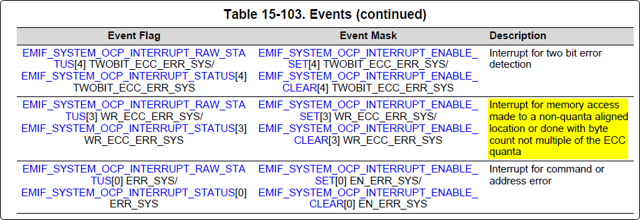

    No this is not correct.  Please see Section 15.3.4.14 "Error Correction And Detection Feature" of the Technical Reference Manual.  In short, all writes must be quanta-sized and quanta-aligned, where a quanta is equal to the EMIF1 bus width.  Non quanta accesses will generate an interrupt:
    Quote:
    • If a write access with byte count that is not a multiple of ECC quanta or with a non quanta aligned address
      is performed within the address range protected by ECC, the EMIF will send out a write ECC error
      interrupt.

  • No. A quanta is equal to the bus width. Assuming 32-bit wide EMIF1 a quanta is 32 bits. That means all accesses to protected memory in SR2.0 will need to be 32-bit wide and 32-bit aligned. Any 8-bit or 16-bit access will trigger an error interrupt.
    Note that any normal cacheable memory being used by the ARM will automatically satisfy these requirements as the cache controller always operates on entire cache lines.

  • Let me paraphrase i882 to hopefully clarify for you one final time... The *intended* operation of the device is that EMIF1 has a protected region and a non-protected region. The protected region would require all accesses to be quanta sized and aligned. The non-protected region should allow any kind of access. The bug described in i882 is that you get a false error reported in-band for the case that a non-quanta access is performed to the NON PROTECTED space. The workaround is to perform quanta sized/aligned accesses to THE ENTIRE EMIF. We will fix this erroneous error reporting in SR2.0. That will allow you to define a non-protected space where there are no quanta restrictions.
