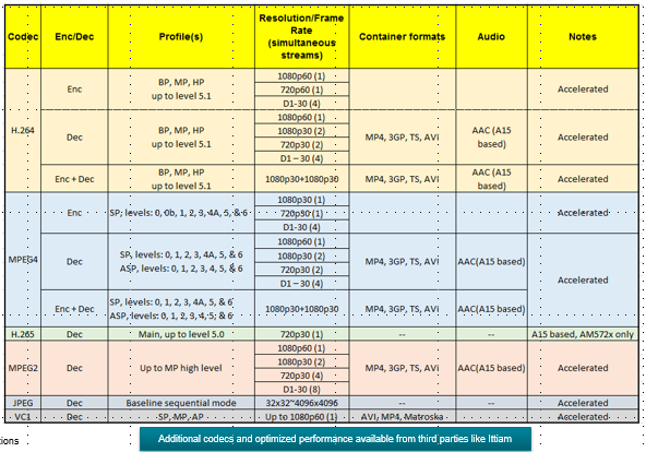

I would like to know the video performance of AM5728.
From Camera, law data is input to AM5728. One video data is encoded three types at same time, and these data is transferred to Ethernet port. As you know, this application is surveillance camera.
1) AM5728 takes 1080p data (30fps), and its data is encoded.(Aspect 16:9)
2) AM5728 takes 1080p data(30fps), and change the size to Aspect 4:3, then its data is encoded (30fps).
3) AM5728 takes 1080p data, and change it to jpeg (1pcs/sec).
This system is no audio.
Does AM5728 have enough performance for handling 1), 2) and 3) at same time, and to send those data to ethernet port?
