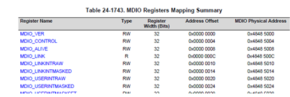

I set those GPIOs in my project, and the project looked like run well. However, the TwinCAT could not recognize the EtherCAT slave device. My questions are:
1. In my opinion, the GPIO settings could not affect the EtherCAT test, am I right? Do those 4 tri-color industrial leds important to the ethercat_slave_demo project?
2. I traced the project, the function 'Board_readFlashStorage' is called. However, the function 'Board_writeFlashStorage' is not called. The QSPI Flash on my board is empty. Does it need to be writed in advance? If it does, what should be written in it?
3. Is there any other thing I need to be notice?
