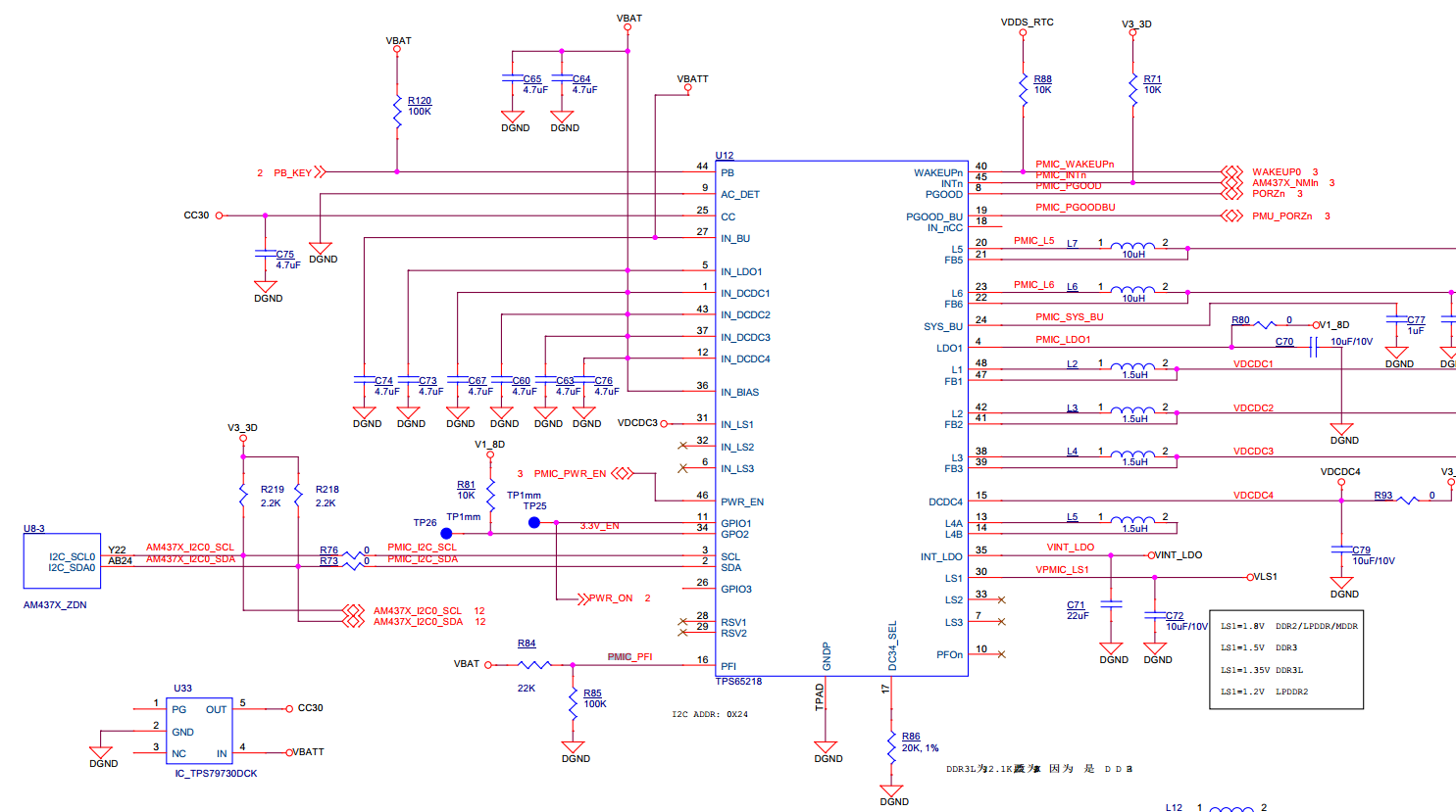

Hi All,
I'm using AM437x + TPS65218, when I do "shutdown" command in kernel, the board will be shutted down,
but after that when I push the PB button(power up the board), the PMIC will enter WAIT_PWR_EN state after about 20s,
I have dumped the registers of AM437x:
RTCSS_STS_REG: 0x82
RTCSS_INTRS_REG:0x10
RTCSS_PMIC:0x30000
And the PMIC_PWR_EN line is always LOW.
I have to remove the charger and then connect the charger, then the board can boot up normally.
Does anyone have ideas for this issue?
