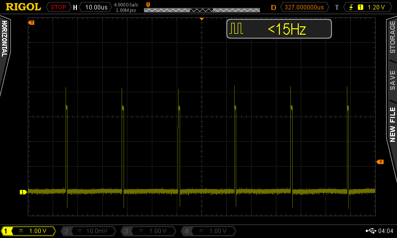

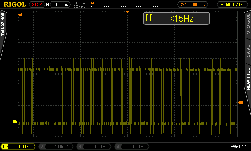

  • Hi Jason,
    Below is the schematic and the scope signals when trying to play audio.  AHCLKX and AXR1 have no signal when trying to play audio.  The configuration is using CKOUT2 is more than likely the issue.
    Thank you for the help.
    Schematic
    BCLK
    DIN

  • George,
    Yes, please make sure that pin D18 is using mux mode 9 (for clkout2 instead of ahclkx) and that you follow the sound0 device tree example from the AM572x GP EVM (found in the Processor SDK v3.2.0.5 in arch/arm/boot/dts/am57xx-beagle-x15-common.dtsi).
    clkout2 should be a clock signal coming out of the AM5728 device that the codec will use as its master clock. From there, the codec can be the clock master and generate the bit clock and frame sync.
    Also, you do not need the aclkr or fsr pins so R391 and R393 can be left unpopulated. Both the transmit and receive functions will use the clocks provided by the codec on aclkx and fsx.
    Jason Reeder
  • Thank you for the response, the MCLK MUX was the solution, I still am seeing DSP kernel panics when I play audio. If the kernel just page faults and does not panic the audio does play fine. I believe this is a different issue than the codec issue I was having, but any pointers on where to check for the DSP issue would be welcomed.
    Thank You,
    George
