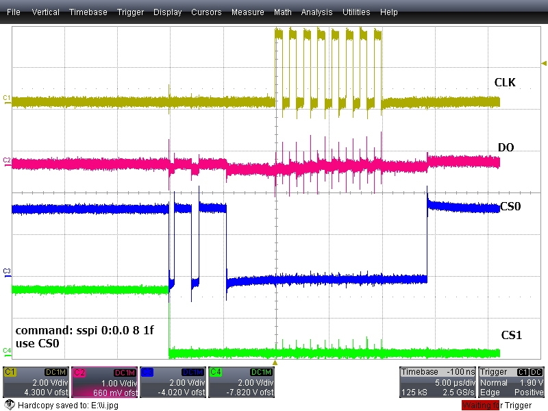

  • Hi Sir
    We used GP-EVM and set profile2 with latest SDK.
    execute command sspi 0:0.0 8 1f and got below waveform
    do you have any suggestion why CS1 pin will become low-level after execute sspi 0:0.0 8 1f  command ?
    execute command sspi 0:1.0 8 1f and got below waveform
    do you have any suggestion why CS0 pin will become low-level after execute sspi 0:1.0 8 1f  command ?

  • It looks like the McSPI is configured for multi-channel mode and not single channel mode so both channels get written to. I was able to recreate it here. I dumped the MCSPI_MODULCTRL register, I saw the register value was 0x00000004 so it is in multi-channel mode.
    Steve K.

  • Working with a hardware applications engineer, we found a hack to get the waveforms correct. It involves setting the EPOL bit in the chconf registers after a reset. I have attach a git diff file. This should get you moving forward while we talk with our software team about a proper fix.
    Steve K.
