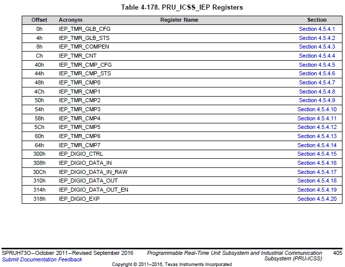

Can someone from TI get the exact value for the following definition constants and variables (using an AM3357):
- CSL_ICSSIEP_CAP_CFG_REG
- ((PRUICSS_HwAttrs *)(pruIcssHandle->hwAttrs))->prussIepRegBase
This constant is used in the following code part of the PRU-ICSS-EtherCAT Slave package:
void bsp_pdi_latch0_control(PRUICSS_Handle pruIcssHandle, Uint8 val)
    Uint32 reg_val = HWREG(((PRUICSS_HwAttrs *)(
                                pruIcssHandle->hwAttrs))->prussIepRegBase +
                           CSL_ICSSIEP_CAP_CFG_REG);

  • Hi Patrick
    It is defined in the PDK in C:\ti\pdk_am335x_version\packages\ti\csl\src\ip\icss\V1\cslr_icss_iep.h as
    /* CAP_CFG_REG */
    #define CSL_ICSSIEP_CAP_CFG_REG                                 (0x18U)
    David
  • Hi David,
    Thanks for the path to the definitions. Now as I have this information I'm quite confused about the register offsets for the AM335x SOC. The AM335x TRM tells me the following:
    But the file "cslr_icss_iep.h" tells me:

    What is the right information? For example the register "IEP_TMR_CNT" has an offset of 0xC from the TRM point of view. But in the definitions there is an other regsiter called "SLOW_COMPEN" with this same offset of 0x0C.

  • Patrick,
    I think both are correct... but they refer to different versions of ICSS_M. Thee TRM describes what is implemented in AM335x ICSS.
    However in AM57x devices we have a newer version of ICSS_M that has more features and as such slightly modified register set too. Now if that is used correctly in the current EtherCAT release that should cover AM335x, Am437x and AM57x at the same time is something that needs to be checked to my mind. This will take a bit of time.
    Where did you encounter the issue with the macro? When just compiling TI example or when writing your own app?
    It may also be related to changes in the base PDK (CSL...). So it requires to look at the correct versions matching the higher layer SW release requirements.

  • Patrick
    I apologize for the misdirection. v0 is correct.
    The mapping is done in C:\ti\PRU-ICSS-EtherCAT_Slave_01.00.02.01\examples\board\include\soc_icss_header.h

    It looks like we may be missing
    #define CSL_ICSSIEP_CAP_CFG_REG      CSL_ICSSM_IEP_CAP_CFG
    I will confirm this with the development team
    David
  • David,
    Thanks for this correction. Your last post was very helpful. It would also be extremely helpful if the AM335x TRM would reflect all the available registers from the ICSS and a description of the bits. This would allow us customers to follow and understand the code better. Especially in the case of source code that is visible to us and maybe needs to be altered because of company-owned of source code guidlines and rules.
    Maybe you can confirm this also to the documentation team.
    Thanks and best regards,
    Patrick
  • Patrick
    Very good. An AM335x TRM update is in process for this that should be released shortly.
    David
  • Patrick
    The development team confirmed that the definition of
    should be added.
    David
