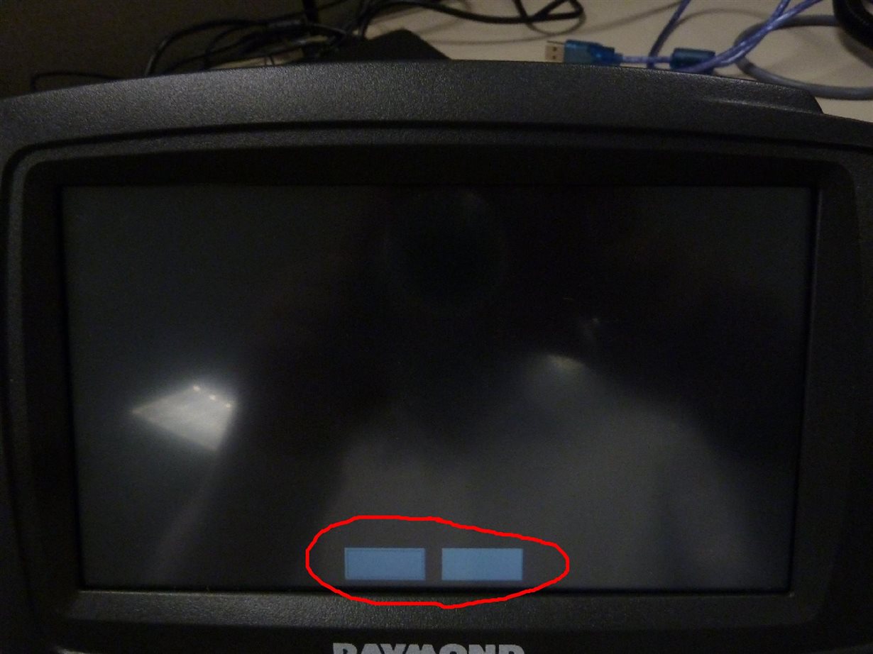

  • Hi Manisha,
    I am able to run the app with additional,
    #export QT_QPA_EGLFS_HIDECURSOR=1
    But, as I mentioned above, main issue is, I am not getting Labels (Any text) on buttons in the running app, I can see the buttons, I can click on them and they function well, But I could not see the labels on the Buttons (I have inserted a Photo for your clarification, the buttons without text/label shown in red mark). I am having same issue with other custom app. Is there anything I am missing?
    Kindly suggest.

  • Hi Divyesh,
    video-graphics-test application has color of the box drawn in white and the text in black. If you are running video-graphics-test application without any modification, I would have expected same color, but it seems that boxes are being drawn as blue color. If colors are messed, then text might not be showing because color of the text might be same as the color of the box. There shouldn't any other reason for box being shown but no color.
  • Do you have AM57x EVM and did you you try running the demo using PLSDK release?
  • Hi Manisha,
    The button is not of color blue, it is of white, it's just the photo taken with an angel that shows the button as blue. I did not run the demo on PLSDK.
    The progress is, I am able to get the camera feed on my custom app. But, in the custom app too, labels/text is not being rendered.
    All the buttons labels and other text are not being displayed, I can do all the functions through pressing those blank buttons though.
    If I change, QT_QPA_EGLFS_INTEGRATION to "none" from "eglfs_kms", than I can see my custom app being rendering text and labels perfectly, but in this case I can not get the camera feed displayed on the screen.
    Can you suggest a reason for text/label not being rendered while "QT_QPA_EGLFS_INTEGRATION=eglfs_kms"?

  • One of the plane being seen (video or graphics) but not both could be due to zorder settings but if you see both the planes but only text is missing, then some QT usage related issue and I do not have any comment there.

  • Adding a custom style sheet to the buttons solved the problem.
    Thanks for help though.
