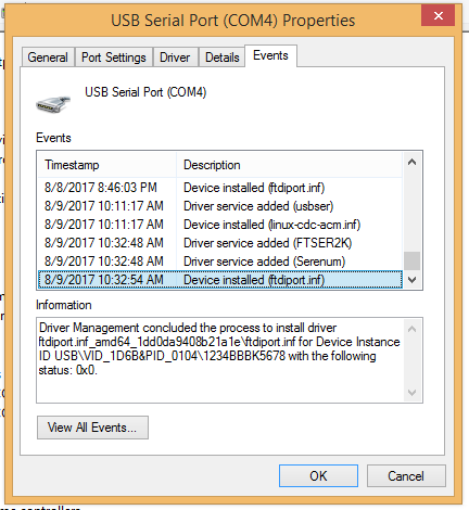

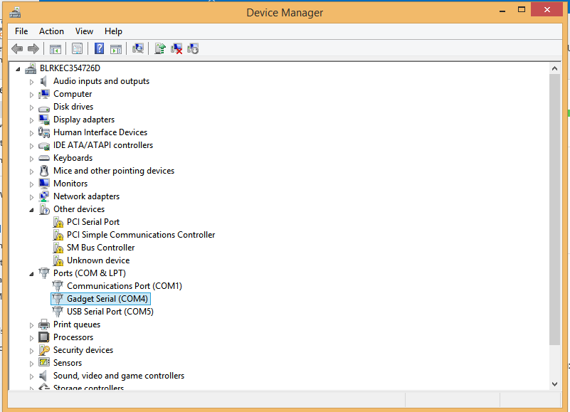

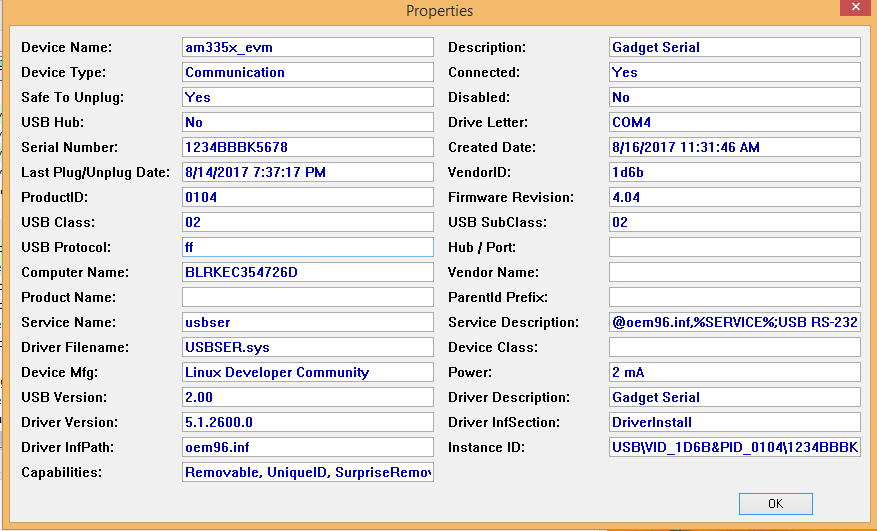

   i have used ti-processor-sdk-linux-am335x-evm-04.00.00.04-Linux-x86-Install.bin for am335x evm. it is emulating a gadget device(ttyACM0) when i am connecting to Ubuntu pc,
 but it is not showing in windows pc.  please suggest what are the drivers need to install.
