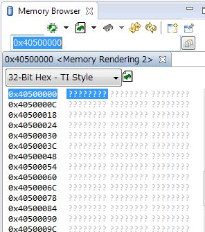

I would like to read the value of L2 cache using CCS.
However, when looking at 0x40500000 with the CCS memory browser, it becomes "???".
I think that L2 is enabled because I am executing the following program.
MMUConfigAndEnable();
CACHEEnable(CACHE_IDCACHE, CACHE_INNER_OUTER);
What should I do to read L2?
    Those two are the common code for enable MMU and setup caches for many test application. When using CACHE_INNER_OUTER flag, pl310 enables it as cache. If you don't enable L2 as cache, are you able to see the 0x40500000 via CCS?
    Regards, Eric
    Some trials:
    The L2 setting as cache or SRAM is controlled by CTRL_MPU_L2 Register (0x44e1_01e0) BIT 16. When SOC out of reset, this default setting is 256KB cache, from CCS I was not able to see the 0x4050_0000. (????? in the window). If I change above register to enable L2 cache as SRAM, I was able to see the 0x4050_0000.
    Then I reset the SOC, and run the typical Sitara examples (like Gpio blink), with the MMUConfigAndEnable() and CACHEEnable(CACHE_IDCACHE, CACHE_INNER_OUTER); Those set-up the L2 cache, I was not able to see the 0x4050_0000 in CCS (???? in the window). I am not sure if this CCS issue or not, still looking into it.

    In Processor SDK RTOS, we also have a way to enable or disable cache and configure L2 as RAM or not using SYSBIOS:
    var Cache = xdc.useModule('ti.sysbios.family.arm.a9.Cache');
    Cache.enableCache = true;
    Cache.configureL2Sram = false;//DDR build
    With L2, I was able to see it in CCS memory window. With cache, I can't see it. I believe this is a CCS issue.
