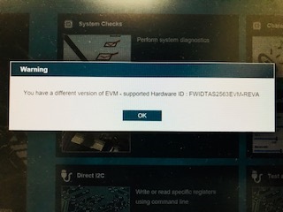

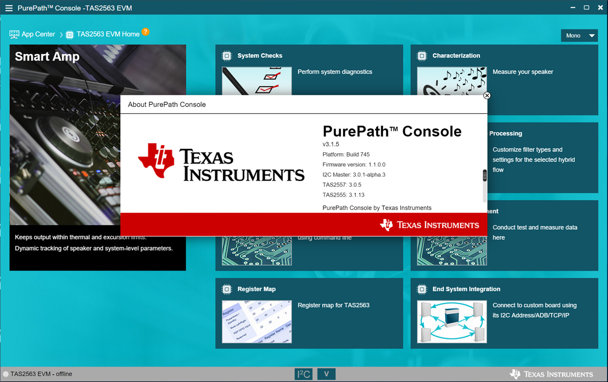

Our customer has just purchased TAS2563EVM (sleu120a with slau800) and ran PPC3.
But attached error message is popped up.
Should we re-order a different version EVM?

They should be able to connect the EVM with PPC3 anyways.
Click on OK button from the Warning message, and then click the "Connect" button at the bottom left corner.
This warning might prevent System Checks to complete successfully, but customer should be able to enter "Tuning and Audio Processing" or "Test and Measurement" to initialize the device.

Hello Ivan-san,
We have ignored ID warning message and successfully complete "System checks" function.

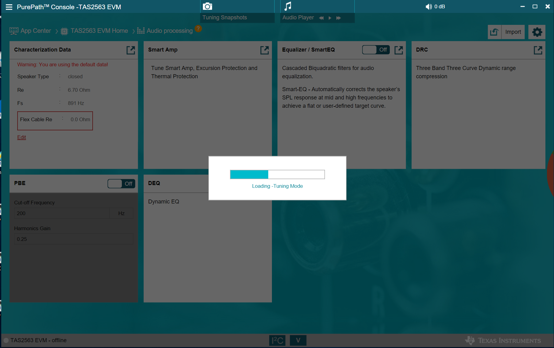

Then proceed to "Tuning tab", PPC3 is not finish "Loading-Tuning Mode" as captured image.

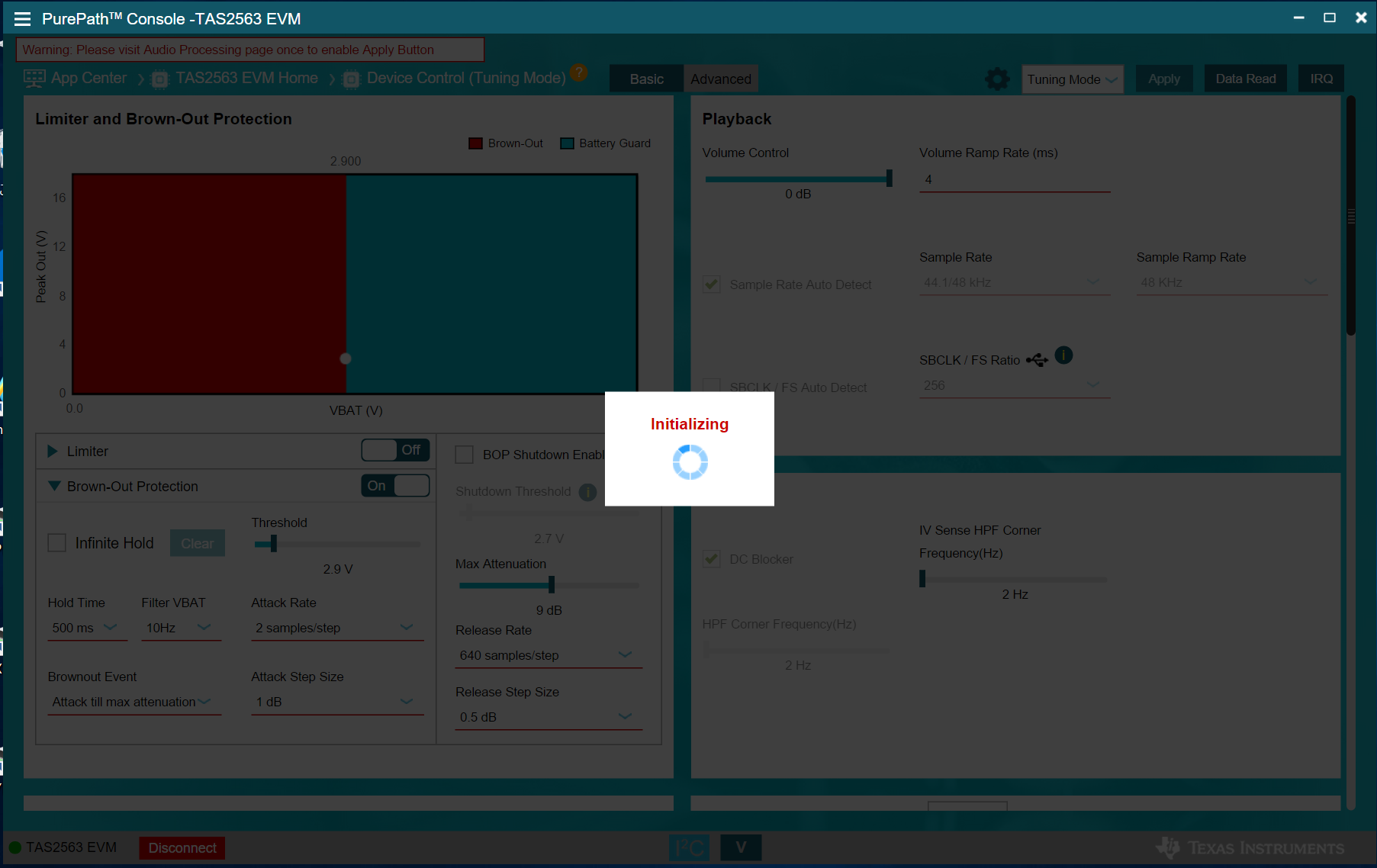

"Device control tab" also cannot finish Initializing.
Do you see any operation issue to start Tuning task?

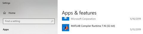

The "initializing" stuck symptom is often related to a bad/missing Matlab Compiler Runtime installation.
Can you verify if this is installed in your system?
If not, can you download and install it and try again with PPC3?

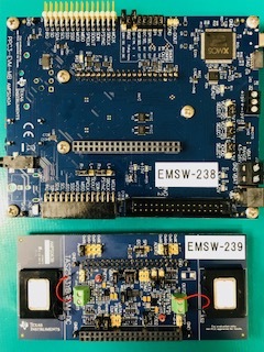

Hello Ivan-san,
I have got customer's EVM in my hand.

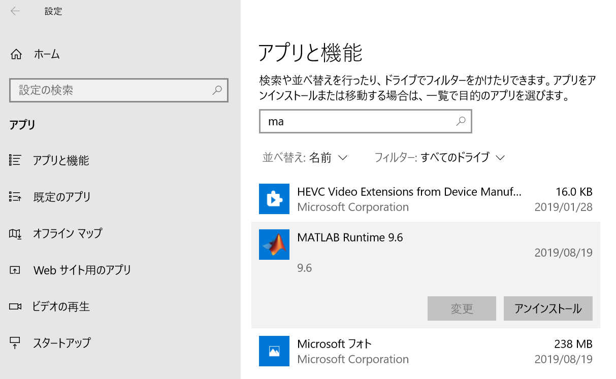

Matlab runtime is installed at C:\Program Files\MATLAB\MATLAB Runtime\v96
On PPC3MB jumpers setting are VCC-I2C=3.3V, VCC-I2S=3.3V, IOVdd=1.8V
On TAS2563EVM removed J1,J4 and J5
1.PPC3 GUI is successfully connected and completed System check with "different version error massage".
Should we re-write "Flash ROM" code or something on the EVM?
2. Then move to characterization panel, there is nothing Button to proceed characterization test.
How can we start characterization?
3. Move to Device control panel, "Initializing" status is not finish forever.
4. Restart PPC GUI and push Tuning and Audio Processing button, again "Loading Tuning mode" status is not finished.
Those are same situation at our customer and my PC.
Is there any missing environment on our Win10 PCs?
Lastly, where can we get TAS2563 speaker tuning tutorial video or manual?

Hi Peter,

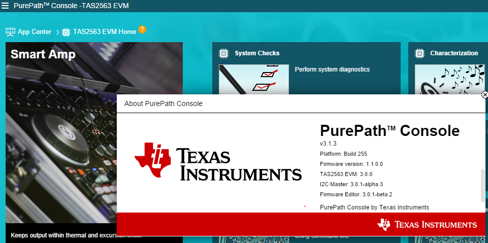

My PC OS version is Windows 10 pro 64bit, version 1803, build 17134.950
But my PPC3 version is not v3.13 like you, It is v3.1.5.
I am curious, there is no TAS2563 device name at PPC front page.
Should I re-install to v3.1.3 PPC GUI? Where can I download previous version GUI?
Mochizuki

Hello Peter,
I still have curiosity. On TAS2563 GUI release note describe as below. Should we prepare LeaningBoard2 together with TAS2563EVM and PPCMB then can we can activate "Characterization panel" in GUI?
Even if we do not have our SPK's characterization data, TAS2563EVM and PPC3MB can be worked without LeaningBoard2?
My PPC3 is the latest release v3.1.5, but your PC and release note specify v3.1.3. Have you verified function of TAS2563EVM GUI on PPC3 v3.1.5.?

Please try with this installer, it should be v3.1.3: https://txn.box.com/s/fggffp8i1hsyn6bykobekq9k9g96n0st

I tried PPC3 v3.1.3 but still "Initializing" status at Device control panel or "Install" status at Tuning and Measurement panel were not finish.
Do you think MCR is not correctly installed in our PC?
Here is the location of MCR.
