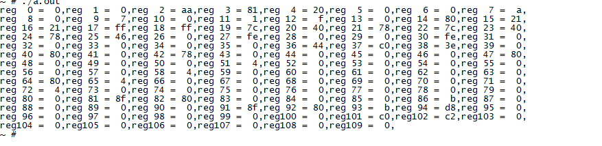

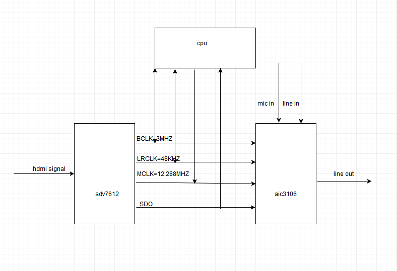

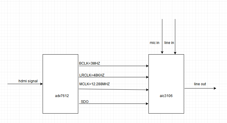

Playing audio through HDMI (16bit, 48Khz), line out can't hear external I2S sound on 3106 chip, the oscilloscope measures MCLK = 12.288mhz, lrclk = 48Khz, blck = 3.072hz, I2S management of CPU is all configured as GPIO input function,
But if the second pin of the CPU is configured as lcrclk function, the oscilloscope measures a waveform of about 300K, and line out can hear the sound. Now the second pin of the CPU is converted into GPIO input function, and 3106 can hear the sound normally. Is lrclk not standard?
