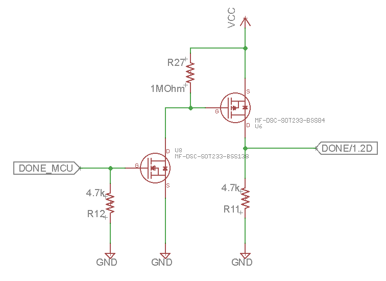

It seems to me like it might be a more robust and simpler approach (than what I've seen in the TPL5111 application notes) to idle the DONE signal to a high state rather than a low state. I've devised the glue logic circuit below to achieve this outcome. With this circuit, the microcontroller has to drive it's "DONE" output HIGH and then LOW to request a timer shutdown.
My thinking here is that this topology will be less susceptible to a glitch during system power up (further inhibited by the passive low pass filter on the output stage. the circuit also serves the purpose of isolating the battery voltage domain (VCC in the schematic below) from the system power domain where the MCU signals resides.
Hoping someone from TI can review this design decision and weigh in on whether there are any significant downsides to this approach?

    The DONE logic on the left is OK, but I'm not certain if the DONE logic on the right is acceptable. TPL5110 expects the low-high transition after the DRV falling edge, with a minimum tDdone spec of 100ns (see table 6.6).
    Kind regards,
    Lane
  • I am suggesting that in order to induce a shutdown with my circuit, the microcontroller would induce action to generate the signal on the right, by stimulating the input on the left. As such the TPL5110 would get a low-high transition at the trailing end of that sequence.
    t_DONE is required to have a minimum pulse width of 100ns (merely implying that the HIGH state has to persist for at least 100ns to register as a rising edge), per the Electrical Characteristics table in section 6.5. It's not actually at all clear to me what tD_DONE is meant to constrain. It is described as "DONE to DRV delay" with bounds of { min: 100ns, max: t_DRV } from DRV falling edge. To me that means that from the time a rising edge is presented on DONE, DRV will be re-asserted HIGH no less than 100ns and no more than t_DRV ns after the DRV goes LOW, subject to the a LOW to HIGH transition on DONE.
    While the timing diagram depicts the an idle state of the DONE signal as LOW, I am asking whether that is in fact _required_, because I think it would be more reliable design to have it idle in a HIGH state to prevent false-positive DONE signals during startup, at the expense of having to issue a HIGH to LOW transition followed by a LOW to HIGH transition on DONE to request a shutdown. I am happy to guarantee some minimum time the DONE signal must be low before the rising edge, but I don't see a description of that in the datasheet (maybe that's what tD_DONE is meant to constrain, and it's at least 100ns?).

    We didn't verify a wide pulse on done as you did. It looks like not violate datasheet description. I suggest you could reserve a path to bypass this inversion circuits. And let us know your final test result in a new post in E2E. Thanks for your hard work on TPL5111.

    Let me take a step back here. The circuit that I propose at the start of this thread is actually a _change_ I'm considering to the following circuit, which I have currently implemented and am having a subtle problem with.
    VCC in the diagram above is the battery voltage and ostensibly could be anything from 2.5 to 4.5V, but for testing I'm using a 3V power supply output. DONE_MCU comes from a microcontroller whose power comes from the TPS63050 output configured to for 3.3V. The DRV signal of the TPL5111 is connected, through a simple passive R-C filter (100 ohms / 100nF), to the EN input of the TPS63050. At its core, the problem I'm trying to address with the proposed change is a spurious DONE signal happening (cause unknown) very infrequently (<1% incidence) at the TPL5111 DRV -> HIGH event, giving rise to a meta-stable periodic condition in my system that looks like this at the output of my regulator (TPS63050).

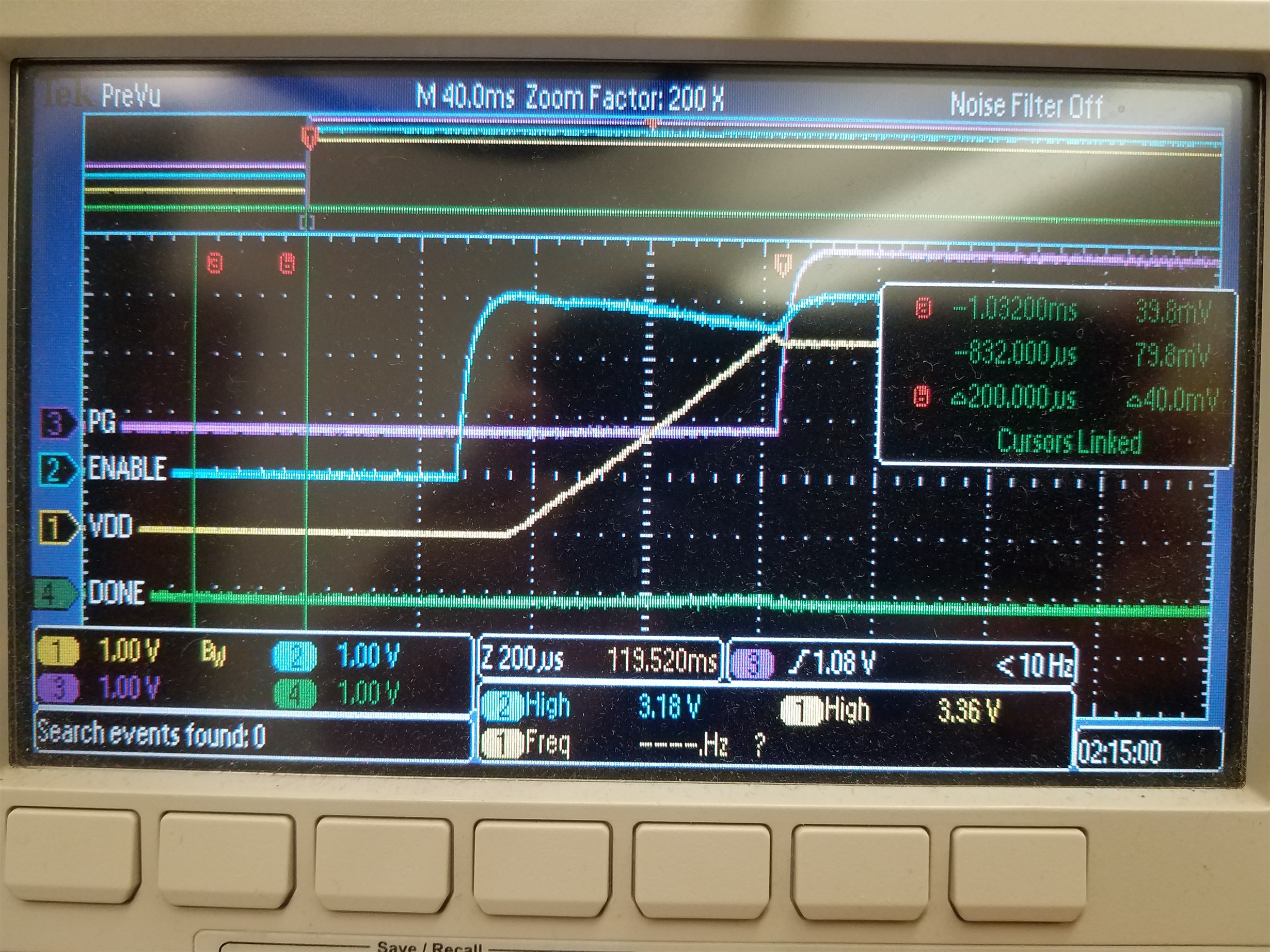

  • This is pretty interesting, I wired up the following signals to the scope and captured a power up event:
    VDD - output voltage of the TPS63050
    DONE - Done signal at input to the TPL5111
    ENABLE - DRV output of the TPL5111 at input to the TPS63050
    PG - Power Good signal output of the TPS63500
    That's 200us per division and 1V per division on all channels.
    One change I'm going to make in my next revision is to wire the Power Good output to the (active low) RESET pin of my microcontroller for good measure. That aside, what I'm curious about is why the DRV output of the TPL5111 decays from the time it comes up until the TPS63050 power good signal comes up, before charging back up to it's ultimate steady-state value. That is pretty peculiar. Is the TPS63050 dragging the drive signal down while it bootstraps, do I need to buffer the DRV output of the TPL5111? That would be a pretty lame requirement from a power consumption standpoint. Do I need to add capacitance to the signal?
