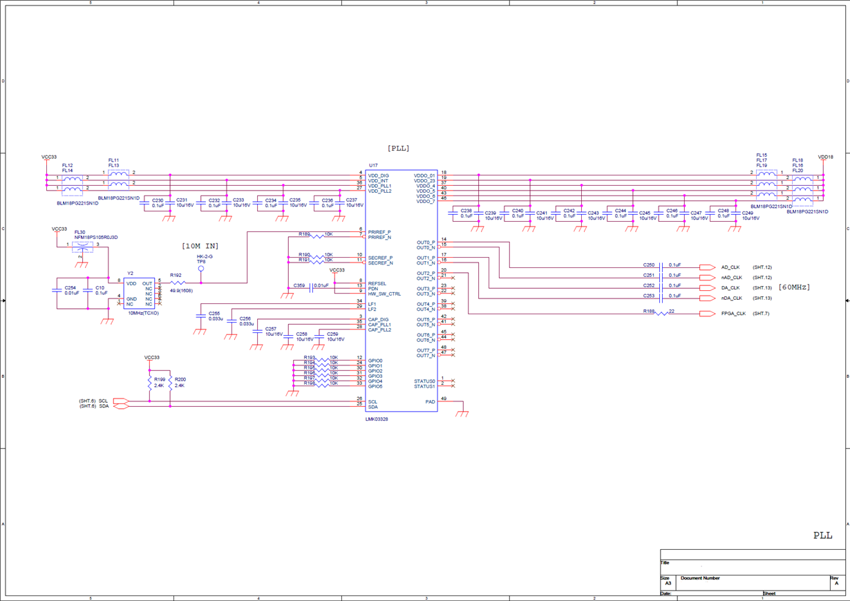

I am having a problem that the PLL Loss of Lock.
It is known that the output of the N divider is stopped.
(Depending on the output of the STATUS0 pin set by R27 [7: 4]=0x4)
The outputs of the R divider and M divider are working normally.
(Similarly, depending on the setting of R27(R28))
How should we debug from here?
WEBENCH data will be attached
