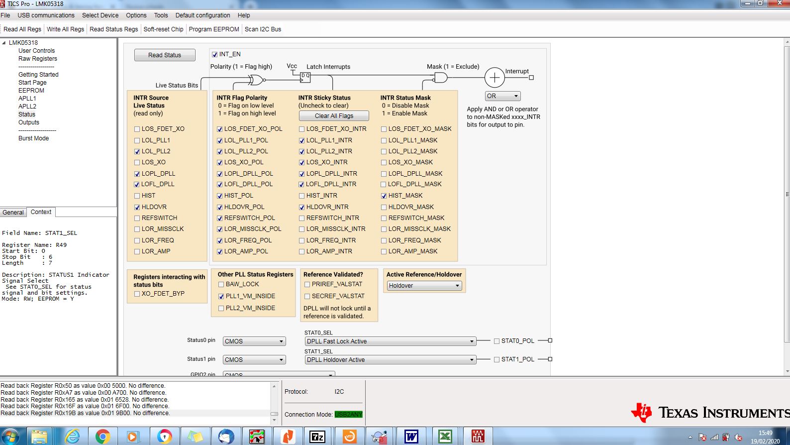

    However, in this configuration the Primary Reference is always considered invalid and therefore the DPLL does not lock to the reference. The flag BAW_LOCK becomes one almost immediately after having powered up the board (I have written the configuration in EEPROM).
    I have tested the configuration also with different 1PPS signal pulsewidths  (10us, 1ms,20ms,200ms and 500ms) as the GPS module (NEO-M8T) we are using is able to configure the output pulsewidth.
    I attach a screenshot of the status window. It is the same for all the tests I have made.
    What I am missing?
    Thanks in advance

  • Hi Gabriele,
    I'm afraid that the on-board 48.0048MHz XO cannot be used for 1pps configuration. This is because 1pps configuration requires very narrow loop bandwidth (0.01Hz). If the XO has too much wander, then the DPLL will have trouble tracking the phase error. So the 1pps phase detector requires a stable XO because it takes in the jitter of 1pps reference in periods of XO clock. If the XO input has too much wander then the PRIREF_VALSTAT won't be cleared.
    A regular TCXO or OCXO with 4.6ppm frequency accuracy should work. For sanity check, you can use an external signal generator which typically has an OCXO inside.
    Besides, the input type for 1pps PRIREF or SECREF needs to be SE(50Ohm) instead of CMOS.
    Hao
