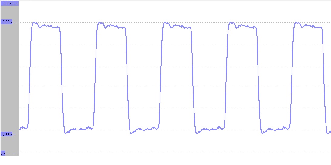

  • The Connor Winfield TCXO that you use as a reference to CDCM7005 has a rise/fall time of 8ns. The CDCM7005 only works with 4ns max. Can you select a different reference which has a faster rise time?
  • Yes, we could use another TCXO - hopefully we can find one with the same footprint. Thanks.

  • Attached is the reference clock as it looks at the CDCM7005 pin. As seen in our schematics the reference is AC coupled into the CDCM7005 thru a 10k/10k divider.
