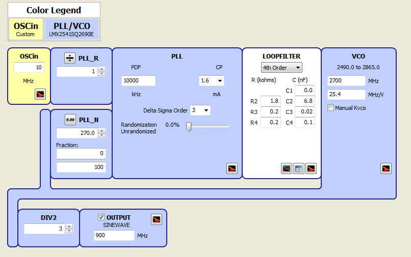

Currently, I am trying to use the LMX25412690EVAL/NOPB to generate a 900 MHz sinewave synchronized by our local oscillator. the parameters can been seen below. the reference clock is generated by our local oscillator.

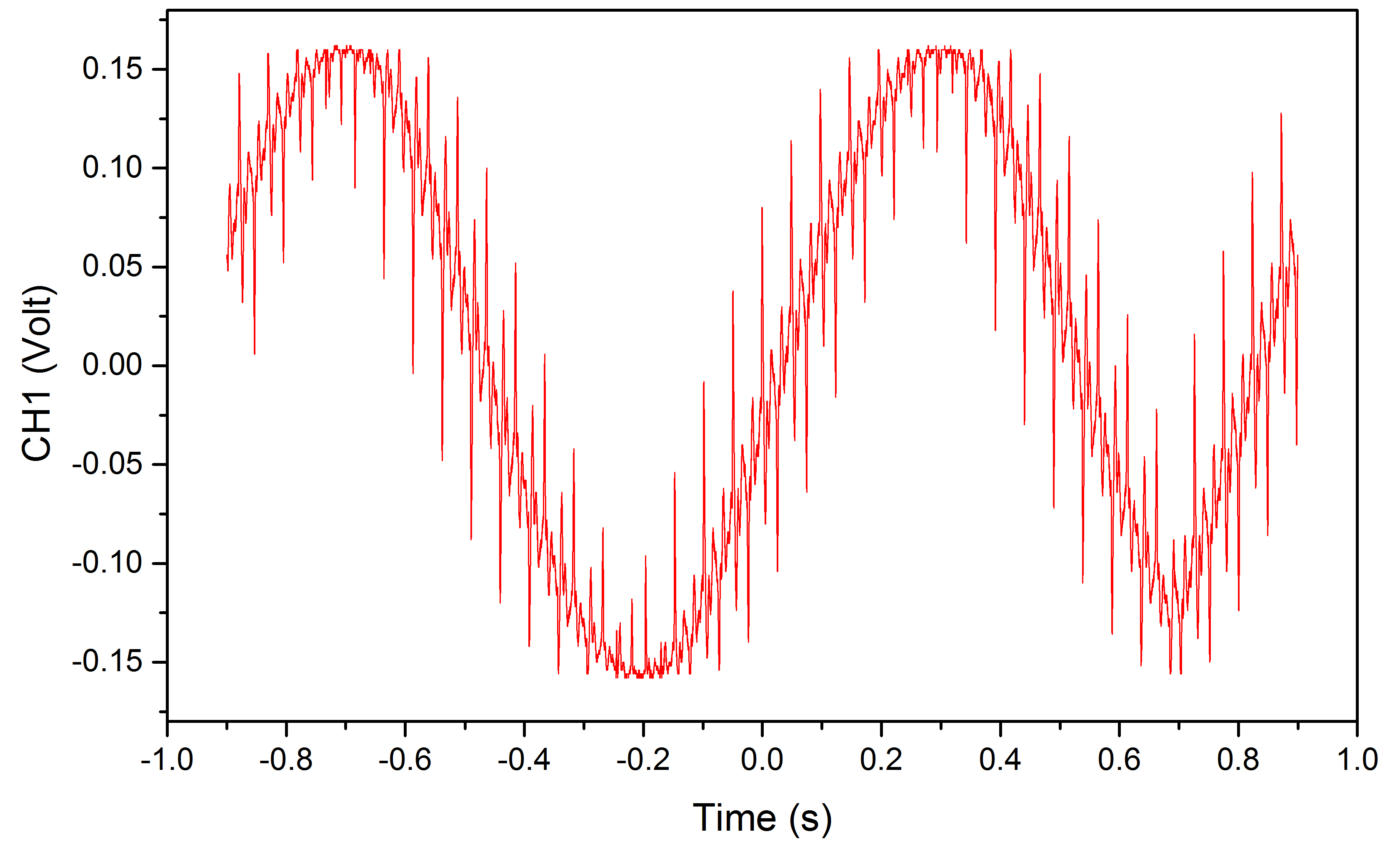

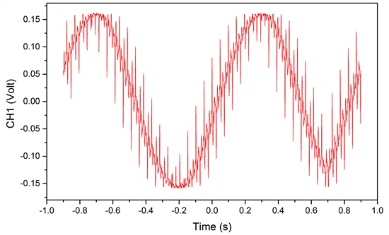

To check the quality of this signal. I mixed this signal with our 900.000001 MHz local socillator (sinewave, synchronized with the same 10MHz clock) to monitor the 1 Hz beating frequency. Here is the reslut:

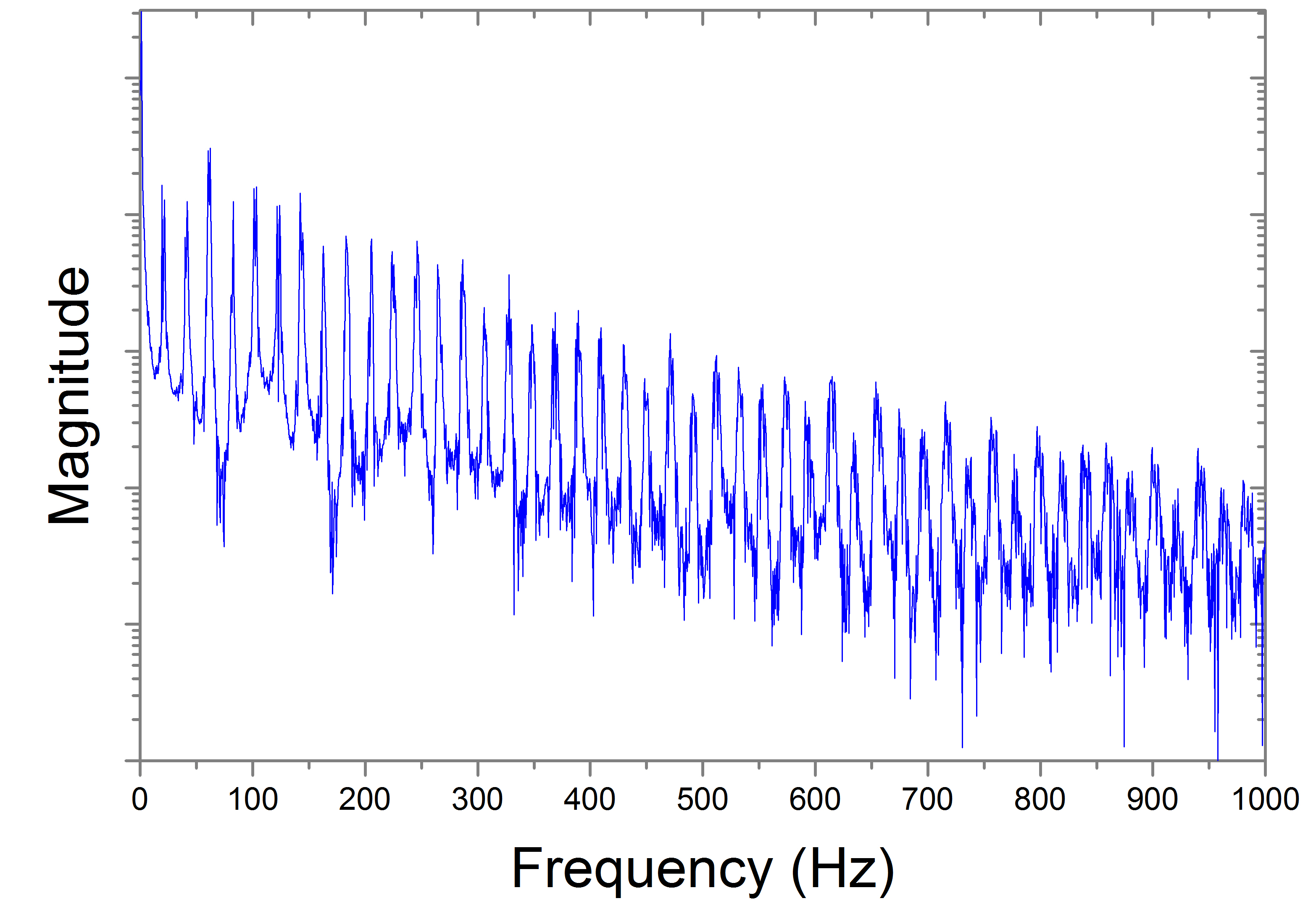

I can see the 1Hz beating clearly but superimposing with a lot of spurs and the reason is not clear. Could anybody give some solutions for this? The figure below shows the FFT of this signal.

    The LMX2541 has excellent spur performance and does not generate spurs in integer mode.   However, if you have the fraction modulator on and dithering enabled it can.  The solution to this is disable ditheriring in our device.
    I am suspicious of whatever is generating the 900.000001 MHz signal from 10 MHz.  In general, when you produce one frequency from another, expect spurs at the greatest common divisor of the two frequenies.  So GCD(900.000001,10) = 1 Hz.  In other words, I suspect that this 900.000001 MHz signal could have very high spurs at 1 Hz offset.
    Dean
