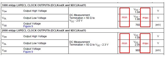

Regarding LVPECL output, would you please provide the min and max spec of VOH,VOL and VOD ?

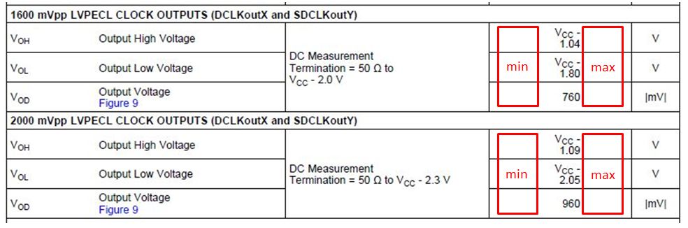

This data parameter is collected at DC and is in a LVPECL standard termination, of 50 ohms to Vcc - 2 V, but often in application a different termination is used such as a 120 or 240 ohm emitter resistor to ground with AC coupling. Consider using the IBIS model to estimate the output voltage swing in your application.
Is there a particular concern you have?
