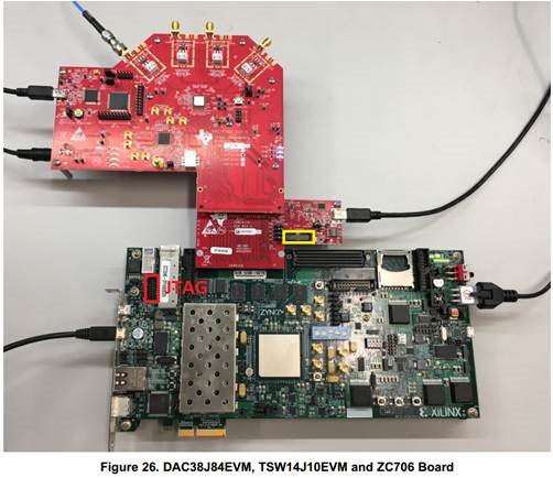

My customer is working with DAC38J84EVM and facing some issues as below.
Configuration: ZC706 + TSW14J10EVM + DAC38J84EVM
Issue 1: In the TSW14J10 FMC-USB Interposer Card User guide, page 32 (with yellow)
Question:  ZC706 board has JTAG,  why it cannot connect to TSW14J10EVM?

  • Trong,
    The ZC706 FPGA does not allow a .SVF file to load properly through the on-board JTAG connector. This is the file format HSDC Pro GUI sends out. This is why Vivado is required to load the firmware. This is what the User's Guide should have mentioned.
