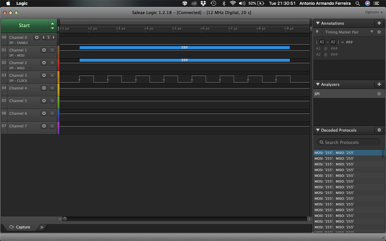

  • Hi Alexander,
    I used a logic analyser to verify the SPI communication, with ADS1292R and I get some curious results.
    After this,  I decide measure with a multimeter  the CS pin of the SPI communication, and I verify  4.60V, it's to high, I think. for this reason I ask if the SPI communication between the microcontroller and the ADS1292R should not take some pull-up resistors
  • Hi Armando,
    The digital pins voltage magnitude should be equal to the digital supply of the device. You may need level translators or pullup/pulldown resistors if the digital logic is operating at a different magnitude for the arduino.
  • Alexander Smith, the problem is solved tank you
  • Wonderful to hear Armando!
    You are most welcome! Please let us know if you have additional questions!
