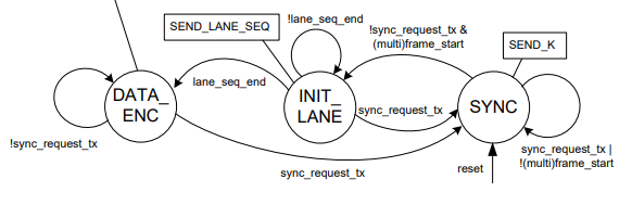

    Does the JESD204B tx state machine in the ADC look like the one in the JEDEC standard? The diagram from the standard (below) makes it look like the only two things that could kick the tx machine out of DATA_ENC are sync_request_tx and reset. I can see now that the sync signal from my receiver is toggling at a frequency that looks similar to the SYSREF frequency. I imagine that is why I am receiving this alarm? Why would my receiver be struggling to get code-group synchronization?
    Do you happen to have a JMODE16 example design that uses Xilinx JESD204B cores?
    Cam
