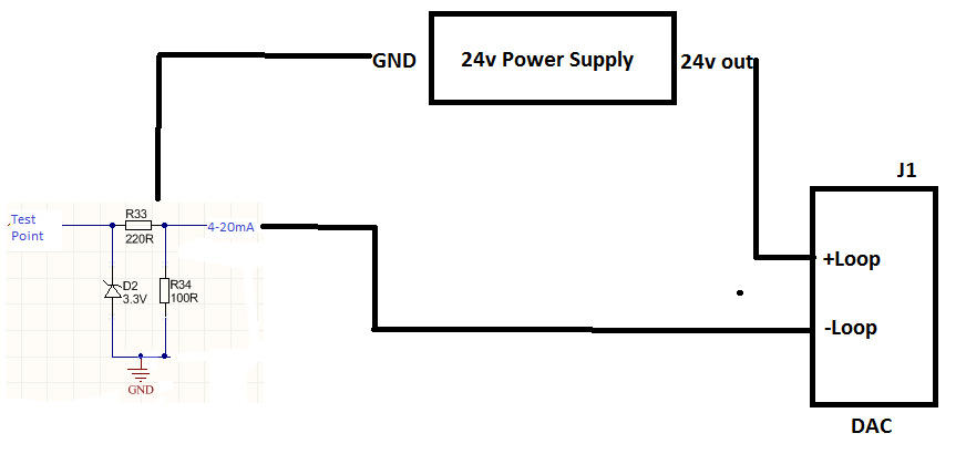

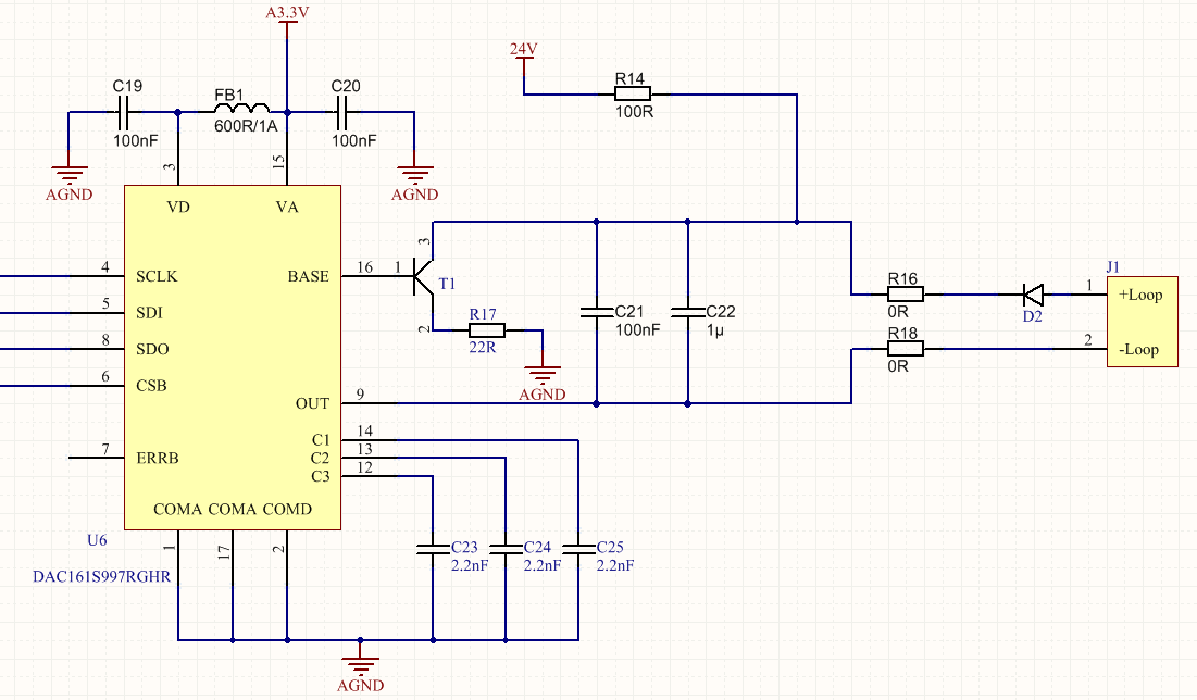

I have msp-exp432p4111 and DAC161s997 and using the firmware of TIDA-00648
        Setup_DAC161  (DAC161_STD_ERR_CONFIG_MASKED, 0, 21800);
        DAC161_Set_Out_Value(x* 2730);
x is the mA value which i want to get but  lets say x =5 , then output is become something like 2.5mA. if i use 5400 instead of 2730 then output is normal until 8mA after that  output changes slower like if x=15 then output is 9mA.
