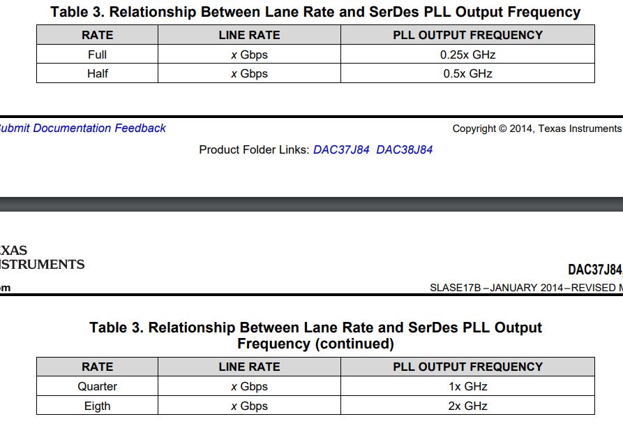

Section 7.3.3 challenges the reader by showing detail of the DACCLK PLL, which is the reference for SerDes PLL, but not the SerDes PLL structure itself. Ultimately, the programmer specifies the SerDes PLL divisors. Absent a diagram of the configuration points (along the lines of LMK manual's figures 12 and 13), it appears that we specify the divisors indirectly, as a function of MPY, Lane Rate (Table 2), and JESD parameter L (perhaps I am overlooking others).
Here is the issue: In Section 7.3.3 "SerDes PLL Output Frequency" appears to mean "F_vco." However, the rows in Table 2 make sense when "SerDes PLL Output Cycle" means "frame clock cycle."
Would you kindly address the inconsistency? It may be that we have overlooked a pertinent detail in the document.

    Section 7.3.2 and section 7.3.3 are strictly highlighting the SERDES PLL, which is different than the DAC PLL (7.4.12).
    The SERDES PLL will basically take a reference clock (a divided down clock from the DAC PLL or directly from external clock, user selectable from register SERDES_REFERENCE_CLK_SELECT) See below registers
    This reference clock can be divided down by serdes_refclk_div and also multiplied up through MPY value
    The final required SERDES PLL rate depends on your line rate. We typically use full rate. For instance, with 10Gbps of SERDES line rate, your SERDES PLL need to be 2.5GHz.
    -Kang

  • Hi Kang,
    One more follow up question, please:
    Q4: In Table 2, does “SerDes PLL Output clock cycle” in Table 2 really mean “Frame" or, equivalently, "Frame Clock Cycle" or "DACCLK cycle" ?
    Thank you for your kind attention to our issues --todd

  • Hi Todd,
    The JESD204B standard basically separates the physical layer away from the link layer and transport layer. The physical layer is the SERDES itself (i.e. the mouth and ears of communication), while the link and transport layer are responsible for the handshaking, link establishment, and data packing (i.e. the smarts or the brain of the communication).
    The frame clock cycle or the multi-frame clock cycle are JESD204B standards to establish a common clock cycle in the link layer and transport layer so the data packets are basically processed at the same rate for both the FPGA and data converter. This sort of making the design common so the standards of different vendor can be compliant with each other.
    the SERDES PLL output is strictly used to sample the serialized bit stream. It in theory should have different rate then the frame/multi-frame clock due to the 8b/10b encoding nature of the JESD204B standard.
    The DACCLK cycle is simply the DAC sampling clock for the output core. This is effectively how fast the DAC can generate consecutive samples.
    the JESD204B standard can be available to download on the JEDEC website. We also have various JESD204B trainings available on TI.com. You can do a quick search on these training materials.
    thanks.
    -Kang
