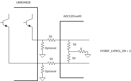

  • Hi Daniele
    Using an LVDS to LVPECL translator will enable DC-coupling the SYSREF signal to the ADC12DL3200 SYSREF inputs. The following termination circuit should be used to help match the common mode voltage between the LVPECL driver and the ADC.
    Also please ensure that SYSREF_LVPECL_EN = 1 before the translator is enabled/driving.
    Please also ensure that the SYSREF to CLK timing is consistent and meets setup/hold at all ADCs in the system.
    Jim B

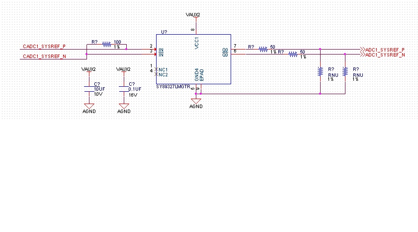

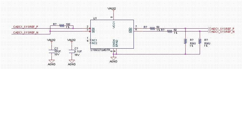

  • Hi Jim,
    thanks for your suggestions.
    I've inserted the circuit below to have the lvds to lvpecl translation for SYS_REF signal.
    Do you think is a correct solution?
    If yes, I will close the chat…..
    Daniele Sassaroli
  • Hi Daniele
    That may work. You may still need the additional resistors to ground from Q0 and /Q0 of the PECL translator. It would be best to include those in the circuit board design and if they are un-needed leave the components un-populated.
    The goal is to satisfy the SYSREF VCMI and VID requirements of ADC12DL3200 datasheet Table 6.3 Recommended Operating Conditions. This is with the assumption that SYSREF_LVPECL_EN = 1 and there is 50 ohm termination to GND at SYSREF+ and SYSREF-.
    Jim B
