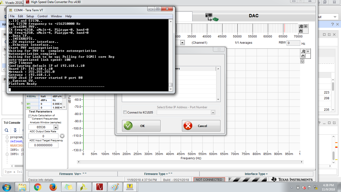

I am trying to use the KCU105 with the ADC32RF45EVM and am following all the steps mentioned in the user guide. I keep getting the following error and am not able to connect to get the setup working. All
other previous steps are successful.
One thing I am doing differently though is that I connect the ethernet port directly to the KCU105 from my computer using a cable and not through any network router. I see the below screen in that scenario
where it says "DHCP time out" which I don't see in the screenshot in the user guide.
Could you please help me troubleshoot and understand where in the reason would lie for the connection not success error and what needs to be done to fix it?
