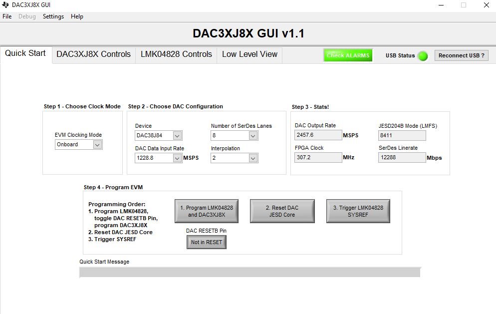

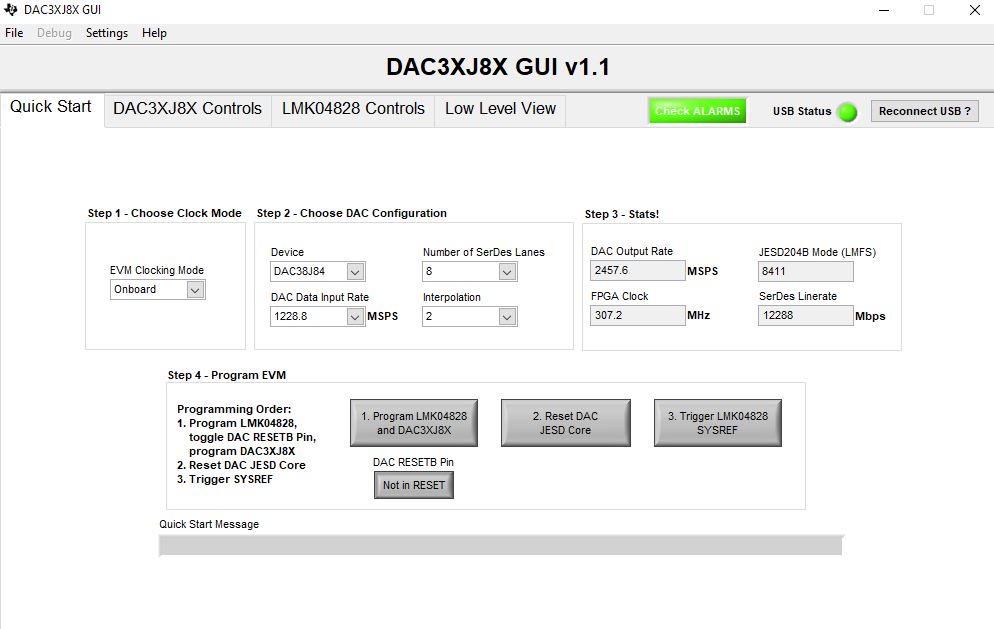

    i am trying to operate DAC38J84 at different frequency but i can only operate it in LMF-442 configuration,
    please suggest me the setting for LMF_841.
    i have tried doing it according to the table recommended by you but no response at output.
    for example my DAC3XJ8X setup is as follows, what else i need to do..?
    also, please suggest the LMK04828 clock output setup.
  • Ravikant,
    you are not giving us enough information to help you move forward. Please attach a ppt with the HSDC PRO screen shot and the steps you are going through to set up the device.
    Based on the screen shot above, the set up will just work.
    Also, it is best that you order the TSW14J56 EVM to check in parallel with your TSW14J10 setup.
    The setup of the TSW14J56EVM per described in the user's guide for DAC38J84 EVM is the most stable setup.
    -Kang

  • DAC38J84_841_1228.8M.pptxDAC38J84_841_983.04M.pptxRavikant,
    Attached are two setup files to follow to get what you want. Since the -2 FPGA device on the ZC706 has serdes that are only rated to 10.3125Gbps, the 1228.8Msps case may not always work. It did work on my setup when I tried it though. The second file I have attached slows things down to 983.04Msps to stay within the spec of the device.
