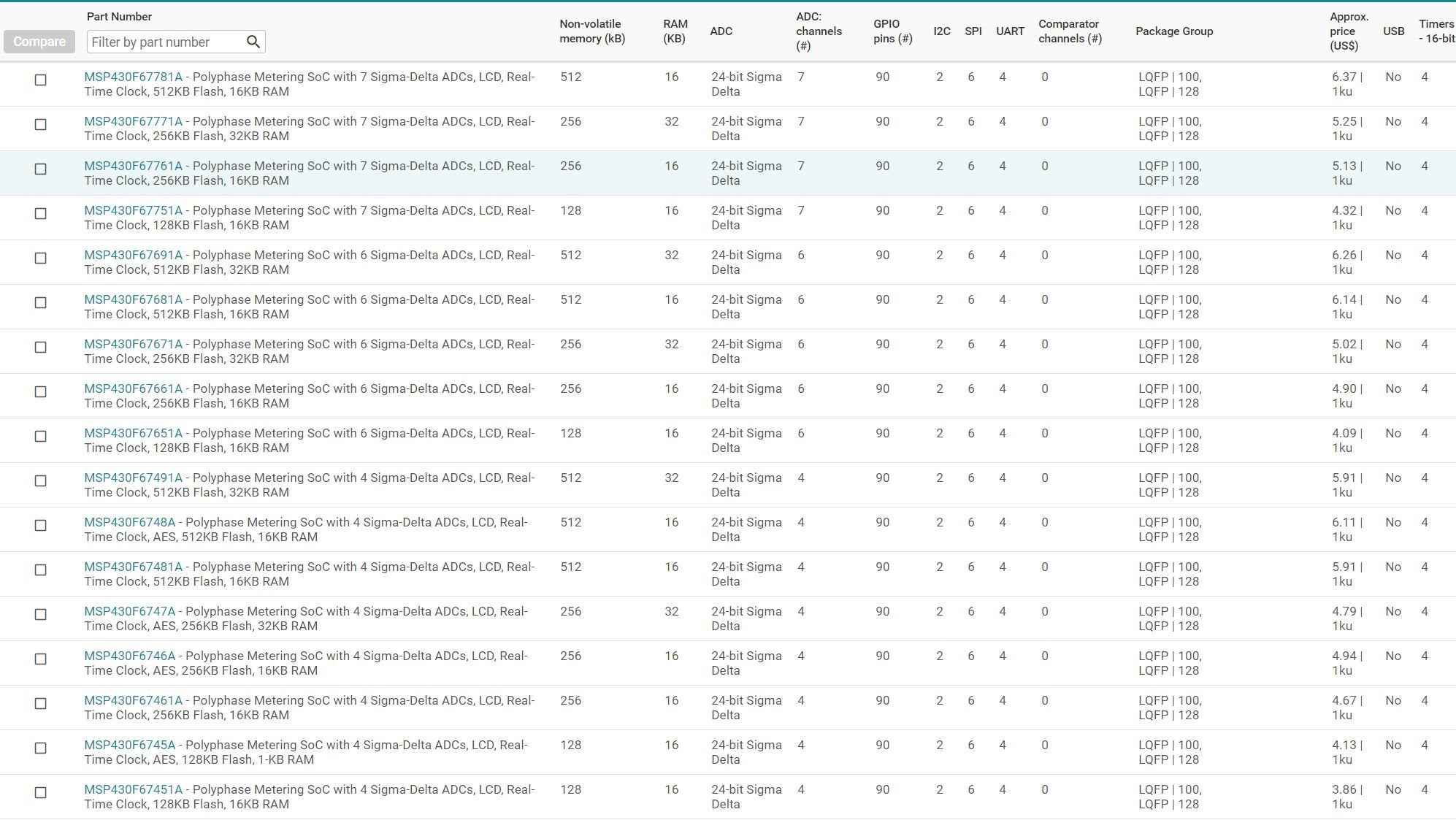

    There have some MSP430 SOCs with integrated 24 bit ADC and segment LCD which is designed for ECG application.  Please search in below page.
    www.ti.com/.../products.html
