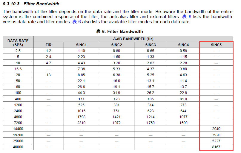

Hi v one,
The interaction between the data rate and digital filter settings can be confusing. The important thing to know is that the data rate always takes precedence. Therefore, if you select any of the data rates between 14.4kSPS and 40kSPS then you'll always be using the SINC5 filter, no matter how you configure the FILTER setting.
