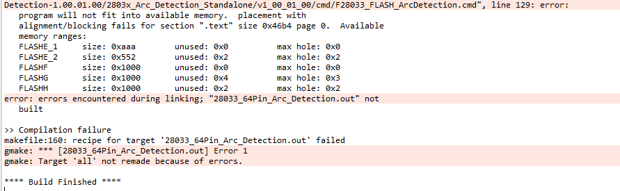

I am using RD-195 Arc Fault detection Development. My built configuration is TM320F28033 / 64 pins package. The only change in the code is in the linker file
where I added FLASHA and FLASHC_1 in the end.
.text :>> FLASHE_1 | FLASHE_2 | FLASHF | FLASHG | FLASHH | FLASHA | FLASHC_1 | FLASHD_1, PAGE = 0
After that I successfully complied the program along with new CRCs in the gGoldenCRC for the changed region.
Problem,
My periodic self test fails randomly at one of the flash sectors (viewed it in debug mode). If I run the program again it runs fine for some time then fails again at the same or different flash / ram tests.
Can you please suggest me what might be the problem ? Any inputs will help.

    Are there any other sections of memory assigning information memory regions to the same locations?
    Ozino
  • Hello Ozino,
    Yes Newly assigned sections FLASHA for 6, FLASHC_1 is assigned for 3 and FLASHD_1 for just 1 information portions of the code.
    All the other one are assigned to1 to 3 regions.
    Rahul
  • Rahul,
    Can you attach a copy of your linker command file? Were there any build errors before adding the addtionial sections of FLASH to the .text field.
    Here is a wiki page regarding splitting memory: processors.wiki.ti.com/.../C28x_Compiler_-_Understanding_Linking
    Ozino

    Before adding the flash region this is the error.
    After addition of extra regions build was successful. without any errors.
    Please find the linker file I have attached herewith.
  • Rahul,
    Can you split the memory for the psa_crc and pc_test_section_1 sections using >>
    GIve this a try and let me know if you are still observe the same issues.
    Ozino
  • Problem in the Safety Test was due to debug mode PSA_CRC calculations.
    Removed from the debug mode and worked like charm.
    Thanks for your help though, Ozino.
