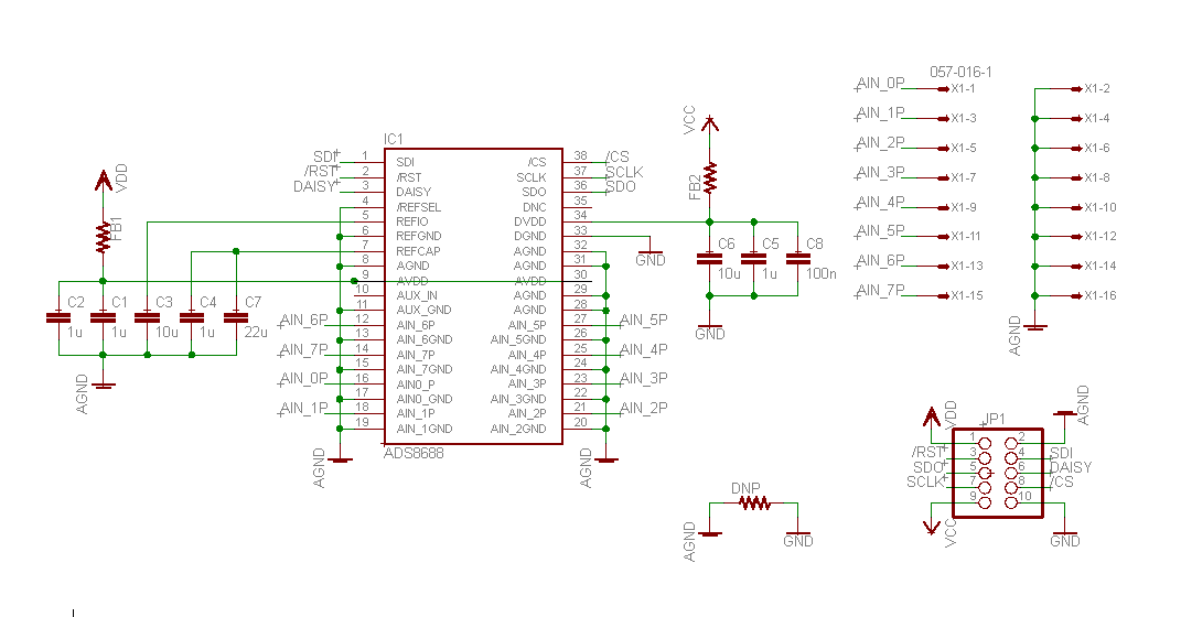

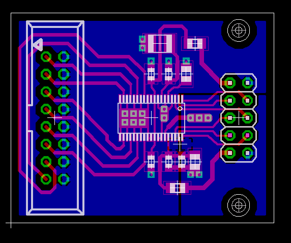

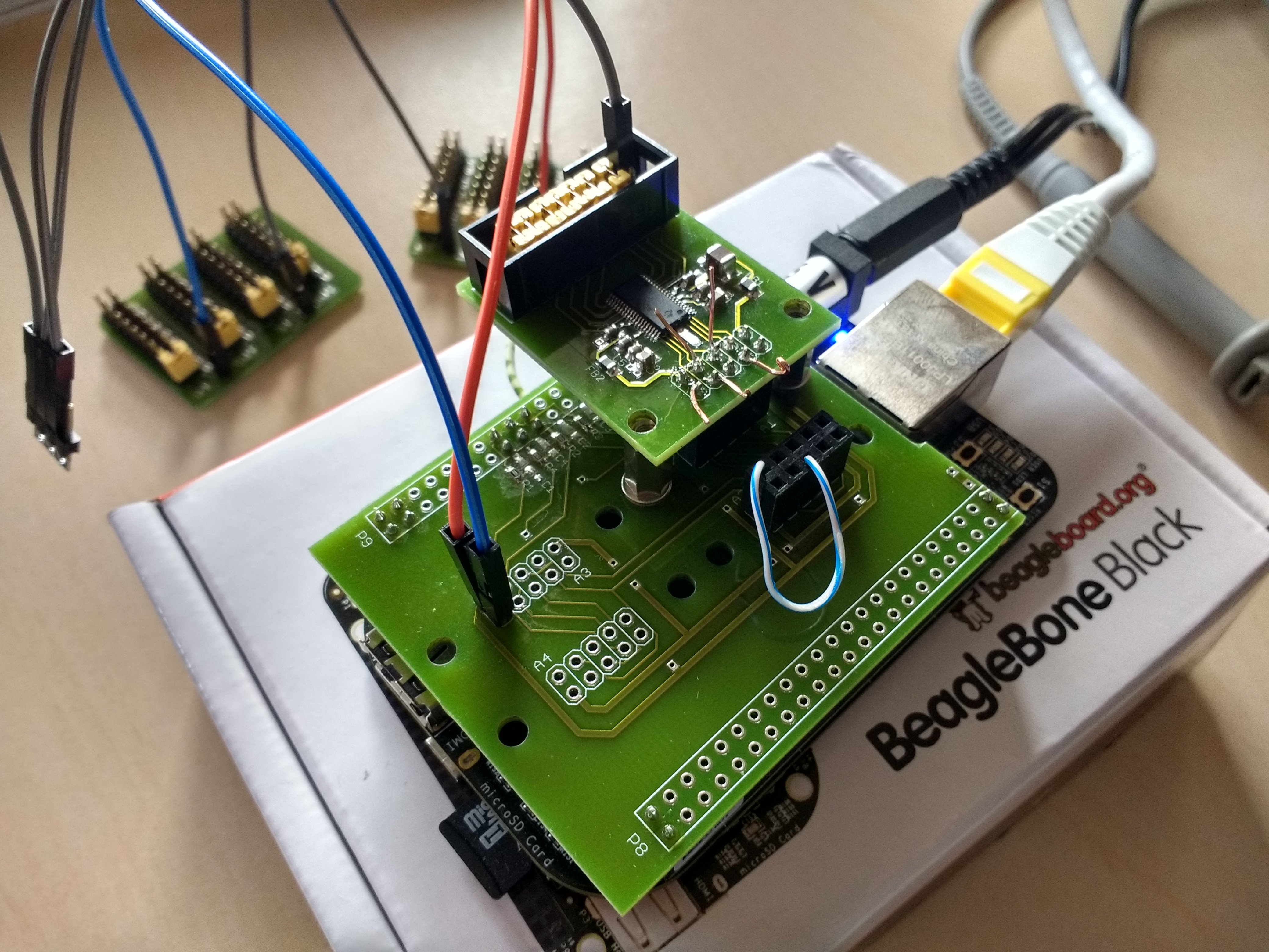

  • Dale,
    I used an Agilent DSO1024A, exported the signals to csv, converted to vcd and opened in GtkWave, a screenshot of which is what you see.
    These are the schematic and board view of my ads8688 daughterboard. Four of these plug into a carrier board, which,
    1. Ties RST of all daughterboards high.
    2. Routes Daisy between boards.
    3. Provides +5V to Vdd (analog supply) and +3.3V to Vcc (digital supply)
    4. Shorts AGND and GND.
    5. Connects daughterboards' SPI pins to BB's SPI via 100 ohm resistors.
    This is a photo of my setup. The carrier board mounted on BB, with a single ads8688 daughterboard (last in the chain). The blue-white wire ties Daisy of the single daughterboard to GND. The copper wire stubs are where I connected the DSO probes. The two boards in the background are two decade resistor boards, currently set to 10k as mentioned.
    Stewie
  • Hello Stewie,
    I will check and get it back to you soon, thanks.
    Dale
  • Dale,
    Ok, so I made the thing work. Adafruit library was the culprit. It spuriously lowers /CS between transactions and I think that causes the chip to enter Frame abort condition.This was hard to find because I've only been looking at individual frames up to now and never between two frames. I've tried another library called python-periphery (github.com/vsergeev/python-periphery) and that worked immediately without issues.
    Thanks for your time.
    Stewie
