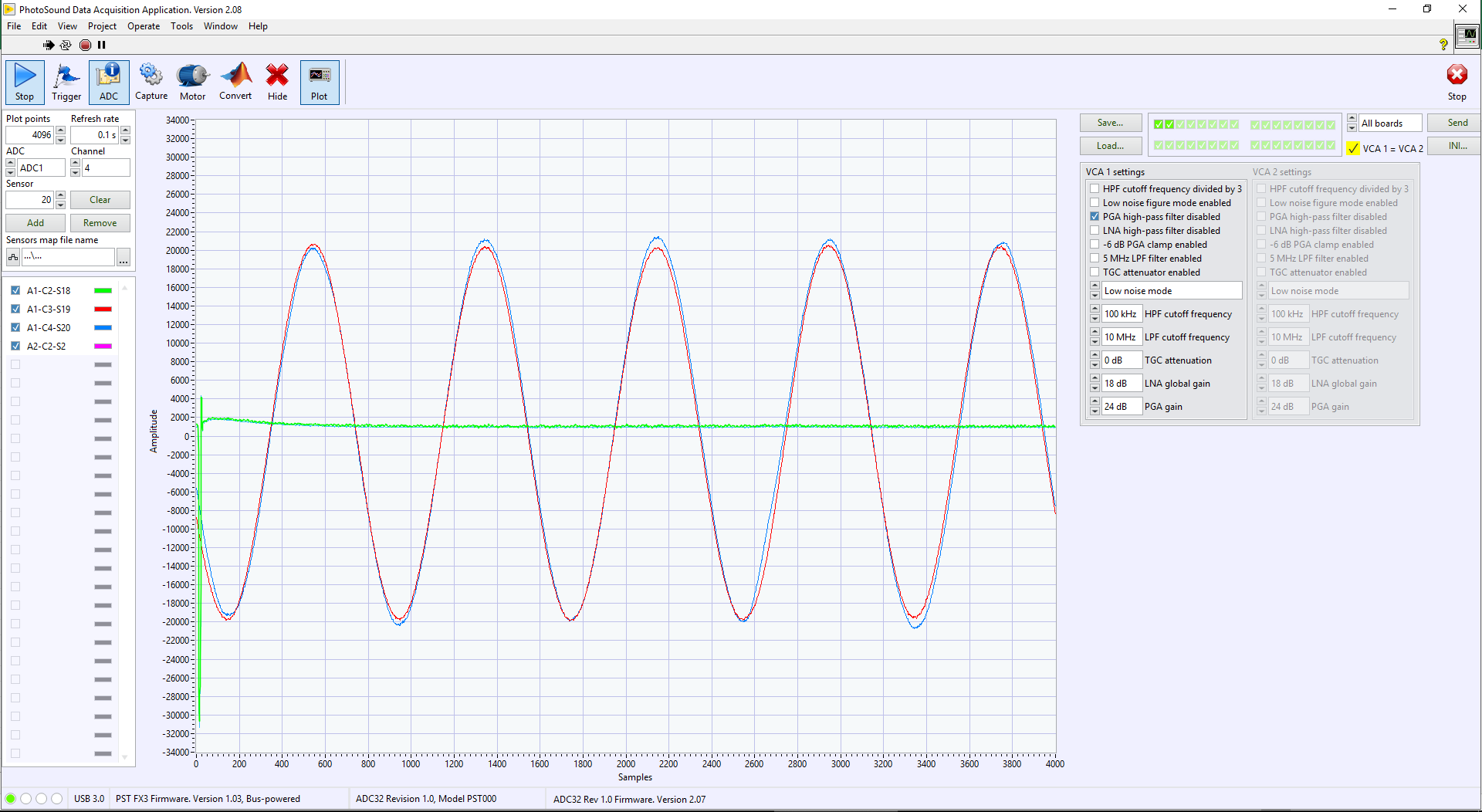

I confirm that PGA HFP in AFE5818 cause high distortion in the signal, for higher input signal amplitude. LNA HPF does not cause any distortion for any signal amplitude. The only remedy against this distortion is to disable PGA HFP. The drawback of disabling PGA HPF is that PGA HFP is much more efficient in removal of DC boas vs LNA HPF.

    To reproduce high distortion try LNA gain = 12 dB, PGA gain = 24 dB, Attenuator = 0 dB or disabled. -6 dB clipping =  disabled. LPA filter  = any. LNA HPF is not important.
    Apply 100 kHz signal from generator and increase the signal amplitude to about 80% of full range. Test PGA HPA = ON and OFF.
    Note that distortion happens only for signals of large amplitude at least 50% of full ADC range p-p. For 25% of full range or less there is no significant distortion.
    Best Regards, Vassili

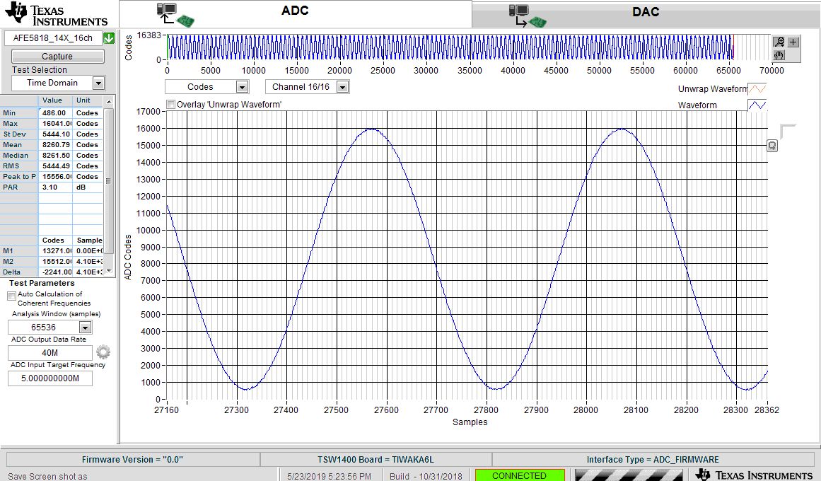

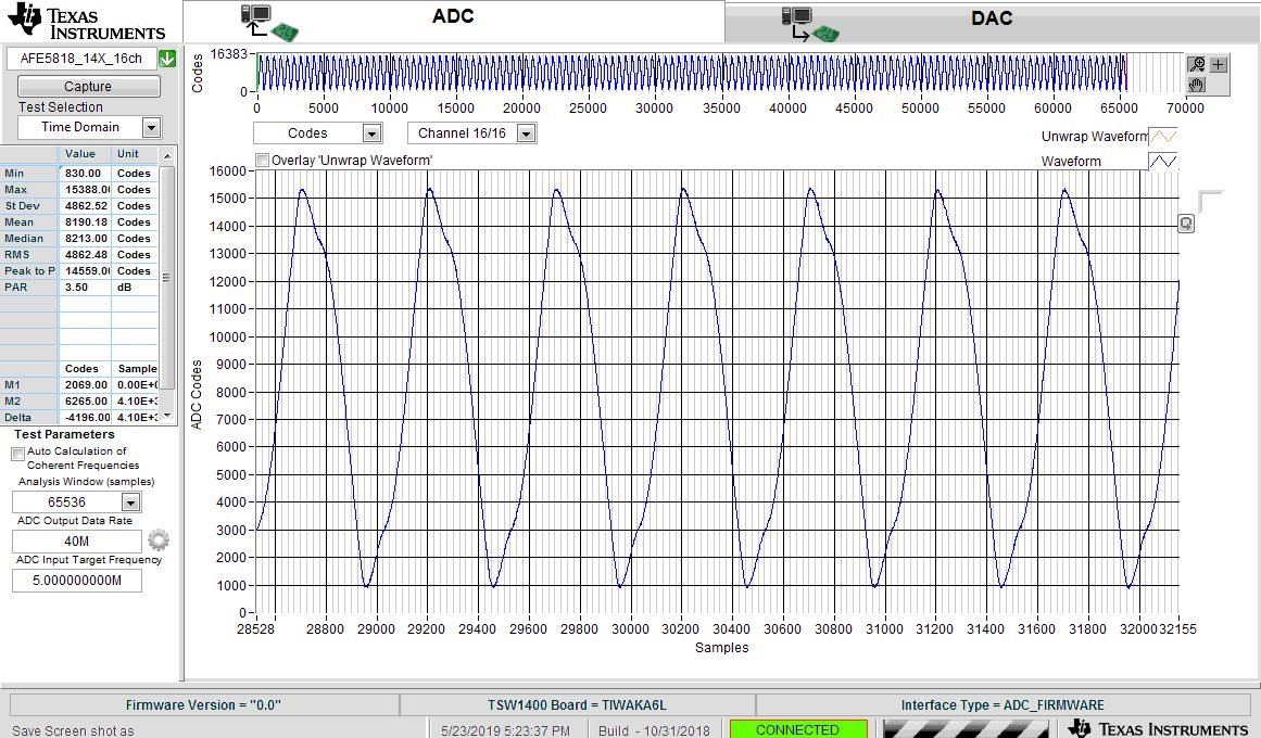

  • Hi Sean,
    I created 2 screenshots with PGA LPF enabled and disabled (in my software). ADC clock was 80 MHz, 12-bit mode, the input signal was 100 kHz. Full scale on screen is - 32,768‬ to + 32,752 (12-bit scaled to 16-bit by multiplying by factor 16 - 4 low bits are zeros).  I just do not see any button on this forum to attach a file.
  •   Vassili,
    your obersvation is correct. we got the same resutls as well. the reason is that PGA HPF filter is set at 80Khz, it is so close to signal frequency. thus it will start to distort the signal. when you care about the 100khz HD2, you can disable the HPF in PGA. our intention is to apply the filter to Mhz signal only.
    two plots  one is diabled HPF, the other is enable the HPF.
    Thanks!
  • Hi Sean,
    Signal is distorted by PGA HFP (HD2) only if the signal amplitude is high enough (but within the range for rest of the signal path chain). Small amplitude signal is not distorted. It looks like the signal within PGA HPF filter goes rail-to-rail or close. LNA HPF does not have such effects. Errata note should be created for this issue.
