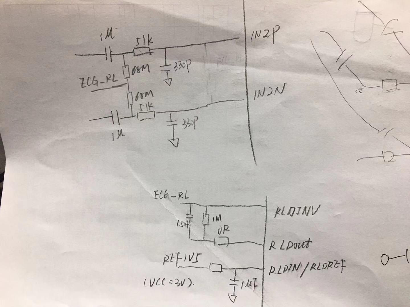

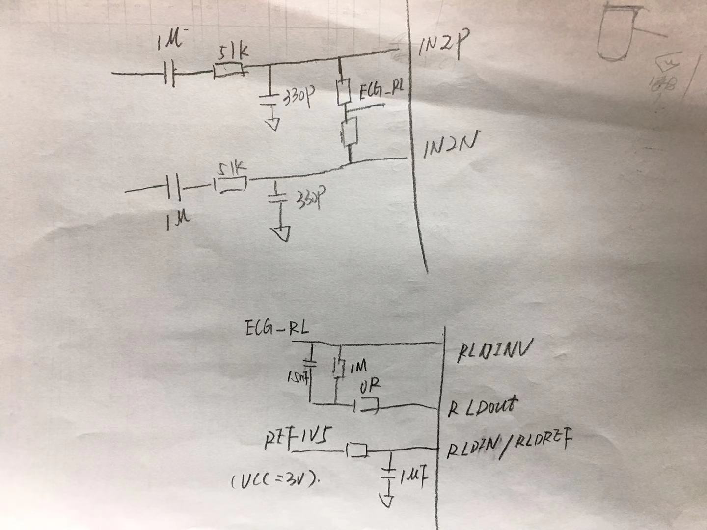

Dear TI experts:
               I have a project that I need use  ADS1292 for 1-LEAD ECG application.  Can I only use 2 electrode to measure 1-Lead ECG without  RLD  ? If TI has  reference design, please share it with me. In addition, what level can the common mode rejection ratio reach,thx.
