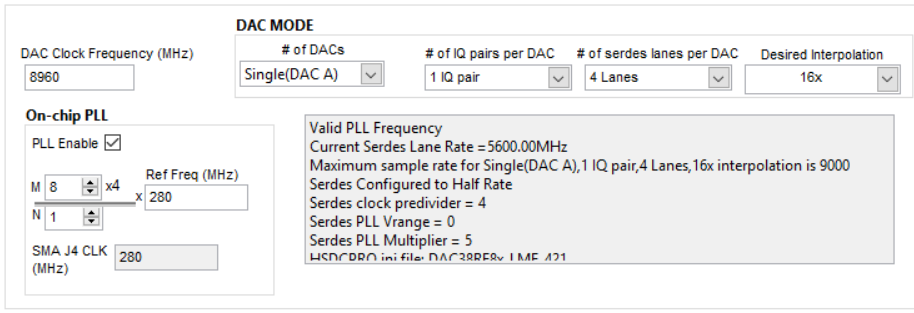

    Thanks for your reply! We have been using the x16 interpolation. By changing it to x8 as you recommended, we do see that the output "shrunk" by a factor of two in the time domain. But I don't think I am able to get x4 or x2 from the Quick Start tab in the DAC software.
    So I am trying to explore the DAC sample rate option. Does that mean that I need to try to increase the "DAC Clock Frequency"? Since we don't have any GHz oscillators, we will have to use the on-chip PLL with our MHz oscillators. I've discovered that there are several discrete valid PLL frequencies with wild guesses of the numbers. So my question now is: how are the valid PLL frequencies determined? Is there an exhaustive list of it? I couldn't find it on the DAC38RF82 datasheet.
    Thanks again! Your helps had gotten us closer to the goal.
    Jiawei
  • Hello Jim,
    So I assumed that the DAC sample rate = DAC Clock Frequency and guessed my way to another valid PLL frequency.
    And I managed to observe a narrower pulse. (the white R1 profile is produced with DAC Clock Freq = 6144 MHz with everything else being the same)
    This seems very promising! But is there a list of valid PLL frequency somewhere? It is the only missing step so far. Guessing isn't the most efficient approach.
    Jackson
  • Jackson,
    The PLL can use one of two VCO's the part has. The frequency range of these two VCO's can be found in section 7.8 of the data sheet.
    Jim

    I've changed the DAC clock frequency to 9344 MHz, and that seemed like the highest value the software can accept. With the x8 interpolation, I observed the following with the 111ps_pulse.csv you've supplied much earlier.
     We see that the width is around 1 ns. But I was under the impression that I could get it down by another order of magnitude. But it seemed like everything I can do is at its limit. What else am I missing?
